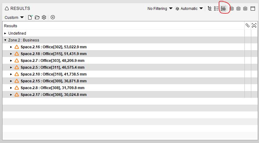

      There is Custom Hierarchy Tab in Checking Results View:
      Maybe this could help. More in our help center: Using Custom Hierarchy to View Checking Results

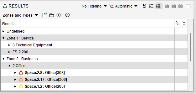

            Did you try adding two levels in your custom hierarchy?
              Sverre
              Im trying. But how can I choose "Space" in Hierachy Level? I can only find navne, type etc. And the you will have every other components in cronological arangement before the space objects. Maybe Im just missing something essential here. But pleace share a printscreen of the settings that you use to only show the space results.
