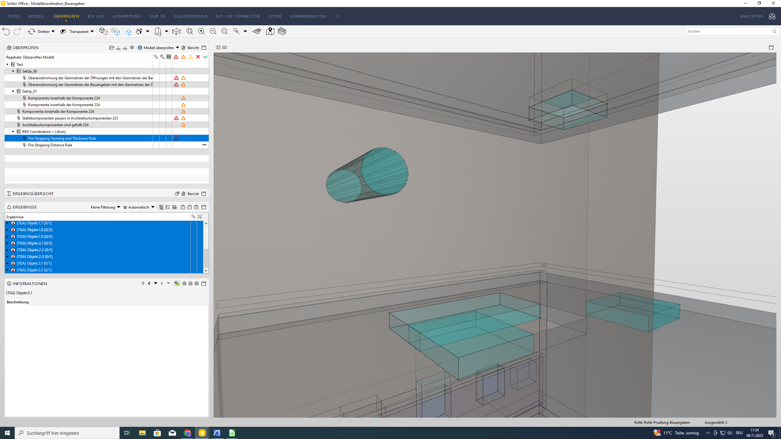

    Dear Solibrians,
    I am currently experimenting on, how I can check geometries of the IfcOpeningElement class against geometries of the IfcBuildingElementProxy.PROVISIONFORVOID class supplied by MEP.
    To do this, I am experimenting with the Fire Stopping Opening and Thickness Rule (Rule ID: SUK/1009/v2.0),
    which is part of the BIM Coordination + extension.
    This rule works fine, but there is a problem.
    I can’t figure out if I can define a tolerance.
    The rule checks round openings as wrong even though its seal fit perfectly. The problem seems to be that these geometries are faceted.
    Does anyone have a suggestion on this issue?
    Thank you very much for reading my message.
    Im attaching a screenshot, as well as a .smc-File.
    Best wishes,
    Oliver
