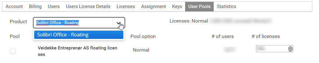

        LeifHagen
        Hello
        I can only find “Solibri Office - floating” both in the individual selected pools and in the Statistics section:
        Regards
        Leif
        • N Offline
          N Offline
          Noushed Solibrians
          It means that you do not have any Solibri Site license and therefore no user can use Solibri Site.
          Regards,
          Noushed
