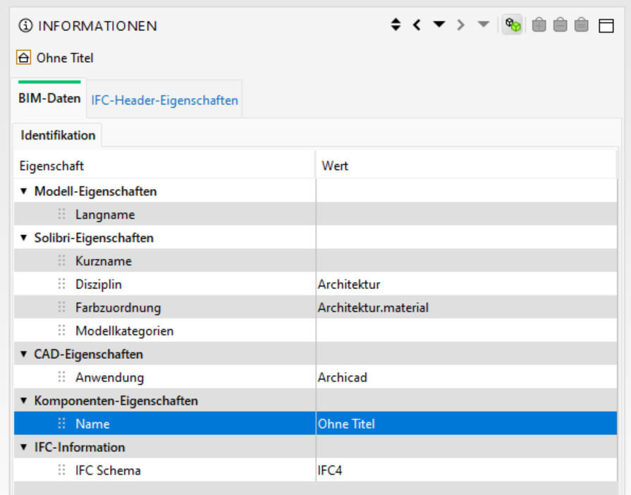

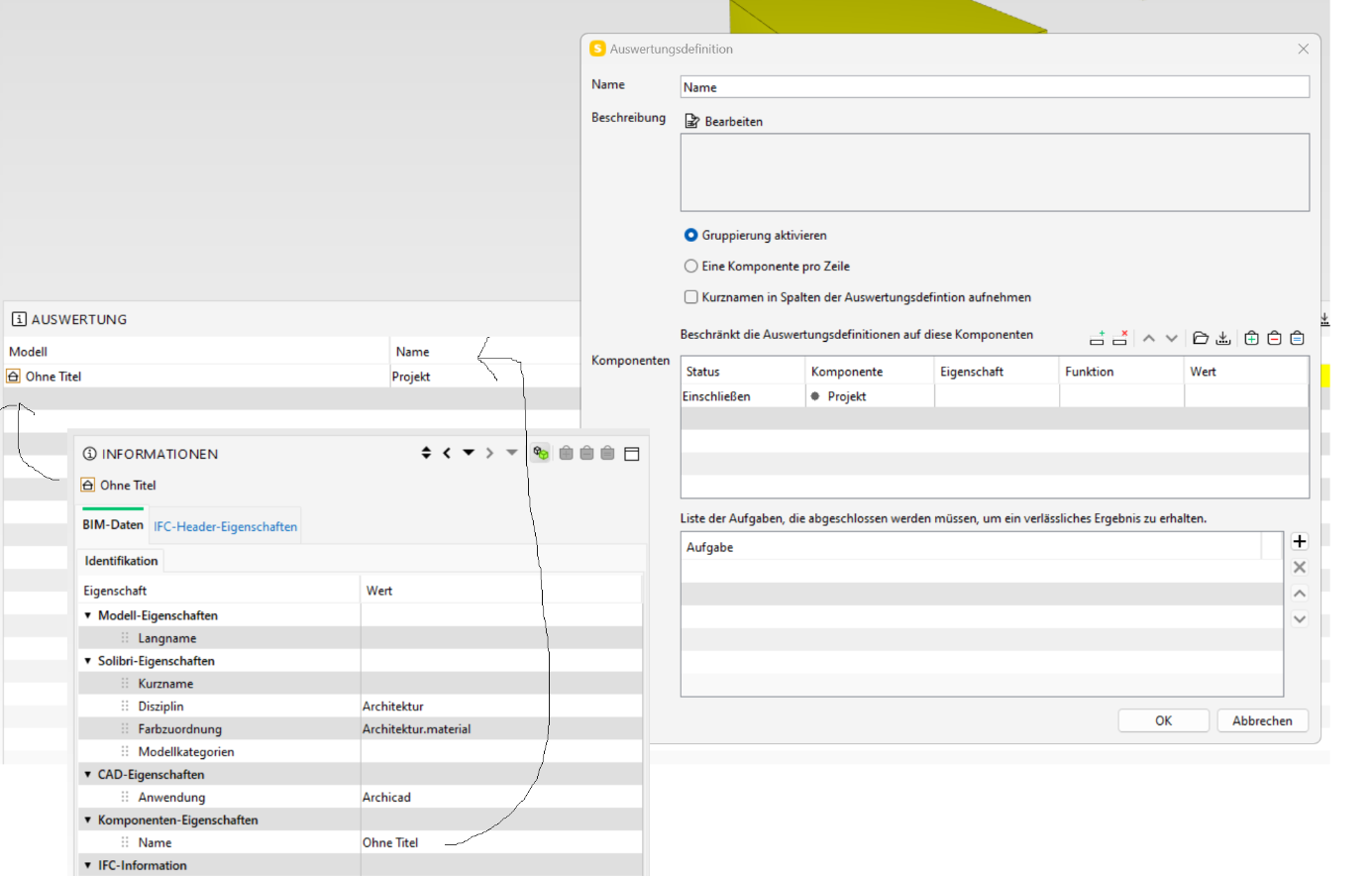

    I though I might check the “name” of IfcProject but it turns out that “name” is actually not visible in the info view as the ITO shows that if I drag it in the value changes. So the one I want to check is actually “Modell” …

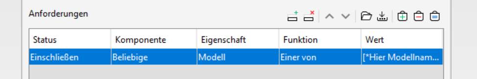

    So tried that one in SOL230 …

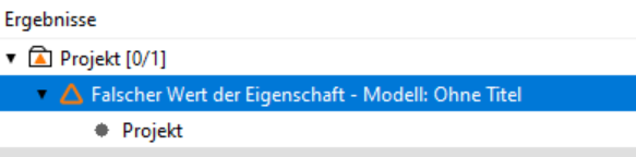

    … with an interessting result:
    … it fails - but why?

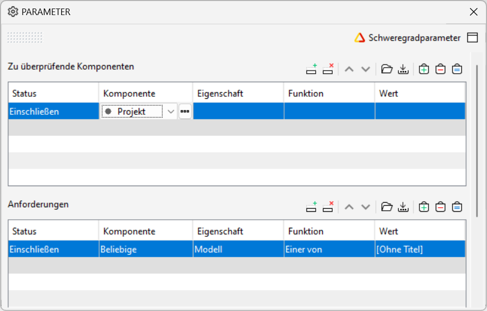

    Btw. with SOL9 it works as expected.
    Edit: but you have to also take the shortname into consideration which is again not totally logical.
