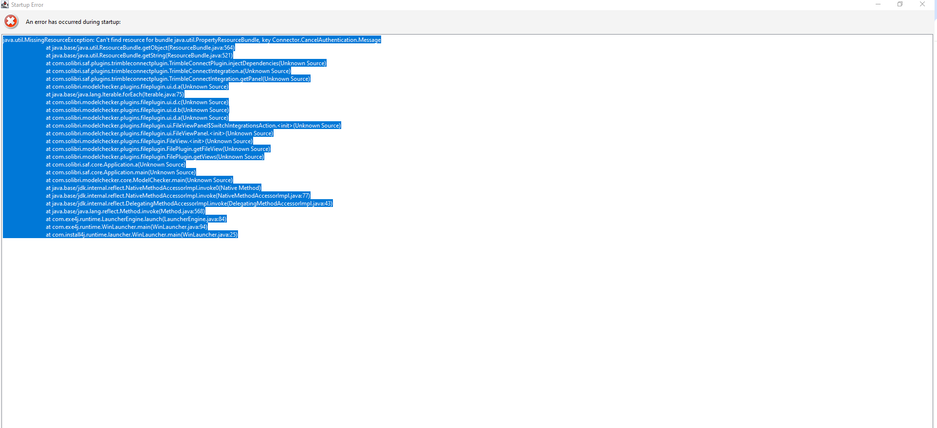

    Hi, I have updated Solibri Office to the latest version and this error occurs.2024-01-02_16h09_47.png
    java.util.MissingResourceException: Can’t find resource for bundle java.util.PropertyResourceBundle, key Connector.CancelAuthentication.Message
    at java.base/java.util.ResourceBundle.getObject(ResourceBundle.java:564)
    at java.base/java.util.ResourceBundle.getString(ResourceBundle.java:521)
    at com.solibri.saf.plugins.trimbleconnectplugin.TrimbleConnectPlugin.injectDependencies(Unknown Source)
    at com.solibri.saf.plugins.trimbleconnectplugin.TrimbleConnectIntegration.a(Unknown Source)
    at com.solibri.saf.plugins.trimbleconnectplugin.TrimbleConnectIntegration.getPanel(Unknown Source)
    at com.solibri.modelchecker.plugins.fileplugin.ui.d.a(Unknown Source)
    at java.base/java.lang.Iterable.forEach(Iterable.java:75)
    at com.solibri.modelchecker.plugins.fileplugin.ui.d.c(Unknown Source)
    at com.solibri.modelchecker.plugins.fileplugin.ui.d.b(Unknown Source)
    at com.solibri.modelchecker.plugins.fileplugin.ui.FileViewPanel$SwitchIntegrationsAction.<init>(Unknown Source)
    at com.solibri.modelchecker.plugins.fileplugin.ui.FileViewPanel.<init>(Unknown Source)
    at com.solibri.modelchecker.plugins.fileplugin.FileView.<init>(Unknown Source)
    at com.solibri.modelchecker.plugins.fileplugin.FilePlugin.getFileView(Unknown Source)
    at com.solibri.modelchecker.plugins.fileplugin.FilePlugin.getViews(Unknown Source)
    at com.solibri.saf.core.Application.a(Unknown Source)
    at com.solibri.saf.core.Application.main(Unknown Source)
    at com.solibri.modelchecker.core.ModelChecker.main(Unknown Source)
    at java.base/jdk.internal.reflect.NativeMethodAccessorImpl.invoke0(Native Method)
    at java.base/jdk.internal.reflect.NativeMethodAccessorImpl.invoke(NativeMethodAccessorImpl.java:77)
    at java.base/jdk.internal.reflect.DelegatingMethodAccessorImpl.invoke(DelegatingMethodAccessorImpl.java:43)
    at java.base/java.lang.reflect.Method.invoke(Method.java:568)
    at com.exe4j.runtime.LauncherEngine.launch(LauncherEngine.java:84)
    at com.exe4j.runtime.WinLauncher.main(WinLauncher.java:94)
    at com.install4j.runtime.launcher.WinLauncher.main(WinLauncher.java:25)]*
      @damien-hyde
      Please uninstall and install again or install to new folder.
      We had similar problem earlier when the update was installed while the application was still partly running.
