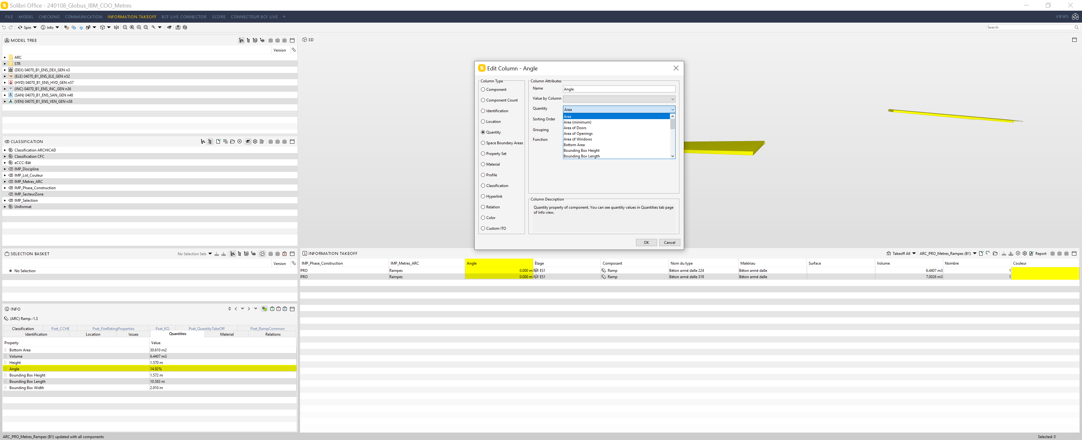

    Hi everyone,
    I try to extract angle (slope) information from IfcRamp in ITO but I don’t find the quantity in column edit :
    I also tried to drag and drop the attribute from Info to my ITO but it doesn’t work either.
    Someone have an idea ?
    Thank you
      Thanks for the report. It really should be there.
        Is the angle preferred as % or as angle in degrees?
        • J Offline
          J Offline
          jeremy.mrts
          Hi Matti, thanks for your feedback.
          For a ramp, it’s better in %.
          • J Offline
            J Offline
            jeremy.mrts
            Hi Matti,
            Has this issue been corrected in the latest release 9.13.8 ?
            Thaks you
              wrote on last edited by Matti
              This is now done in Solibri 9.13.8.
              https://society.solibri.com/topic/2826/solibri-9-13-8-has-been-released
