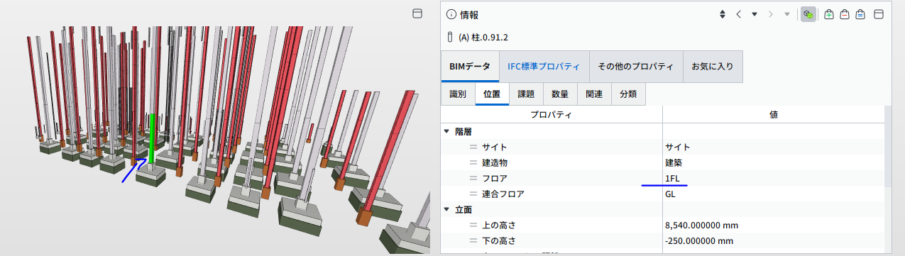

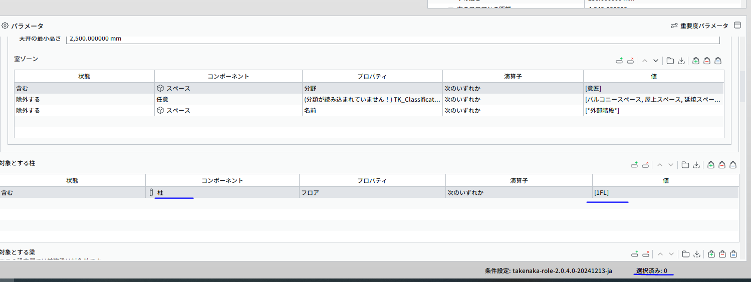

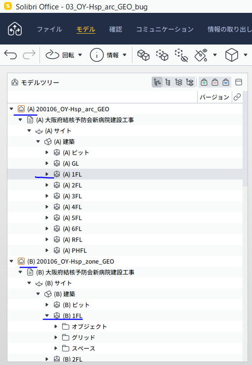

        @Matti I think I found a new bug about this fix.
        These models have 1FL
        But I couldn’t get the components by using floor filter
        Only model (A) has columns
        Maybe the filter is using model (B)'s 1FL not the model (A)
        Please check it out.
