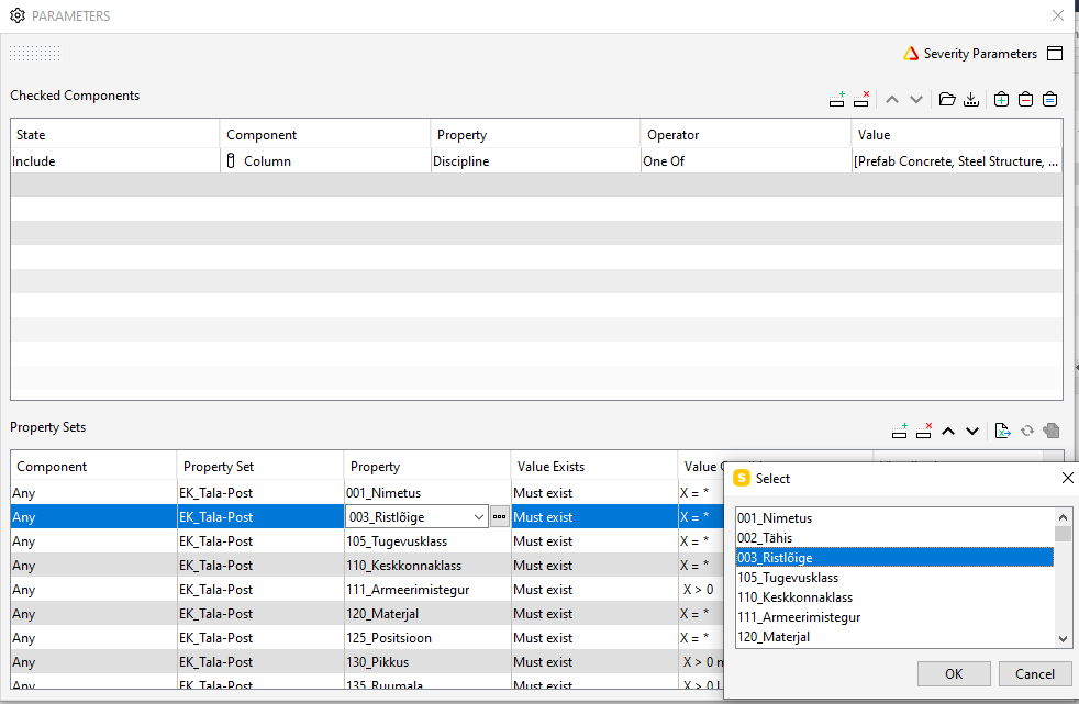

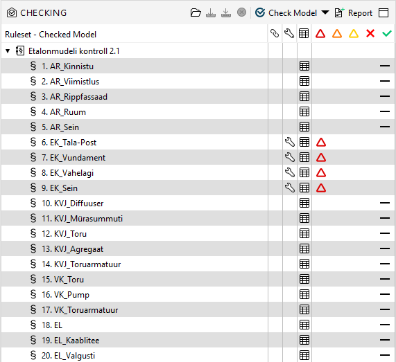

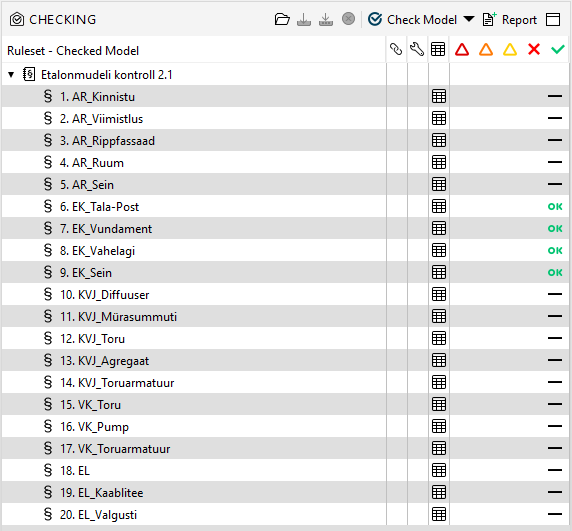

    I have Solibri model where my rule 203 passes.
    Pass.smc
    When I update ifc models with the same exact ifc model the rule does not pass
    d7ba5cc2-4fc7-4396-ac99-020c1e2b6a1a-EK.ifc
    8db05065-8d82-4ba6-a72a-1ce591b8c8af-NotPassed.smc
    When I will reselect this properties in rule parameters then rule will pass again
    What is causing this?

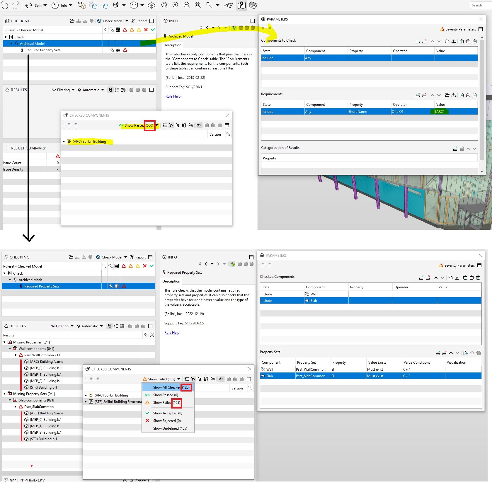

      I would like to add to this post another strange behavior of rule 203 (especially if it is used in gatekeeper rule option), already indicated in the past (https://society.solibri.com/topic/2297/strange-outcome-of-sol-203/3)
      The rule#203 gives a summary of all models since the propertyset was not found in any of the component. In the results are listed also models/buildings with components that are not included in the “checked components” of the rule. This a bug. Do you think it can be fixed soon? Thanks.
      Here an example: Solibri Building_203.smc

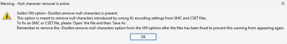

                  I use version 9.13.8.
                  I tried to fix the smc file (posted above) by adding option -Dremove-null-characters=true to Solibri.vmoptions, and, when I started Solibri, this warning appeared:
                  I opened the .smc file and re-save it. solibri-building_203 FIXED.smc
                  Unfortunately I continue to see all the models in the results even if the check has been set only for those created with Archicad.
                  It’s probably better to wait for the next version that fixes everything?
