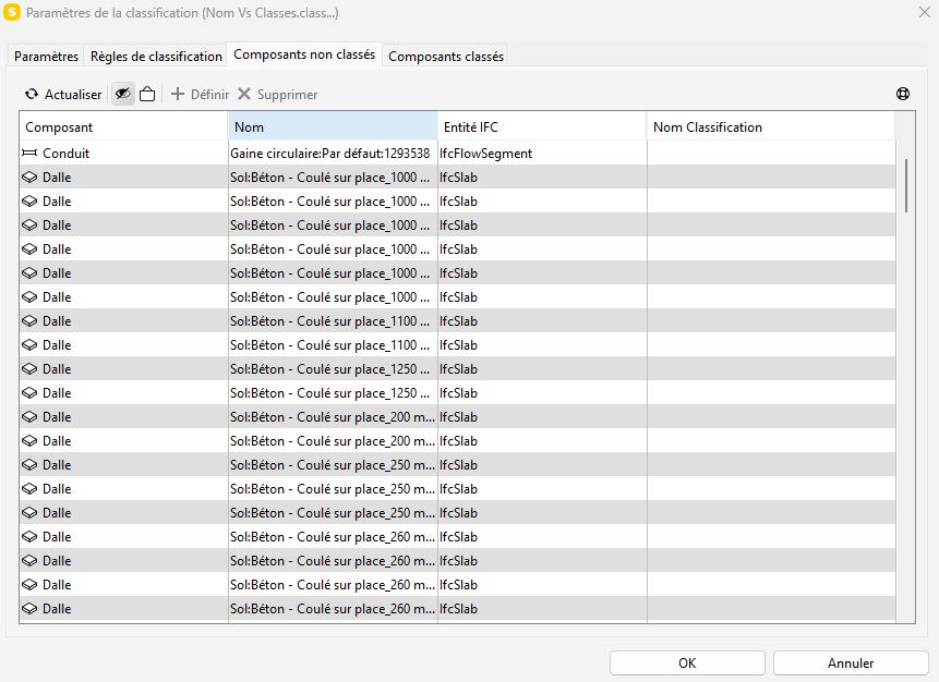

    I’ve developed a classification system to identify elements, such as labeling a slab as ‘IfcSlab.’ However, I’ve encountered an issue where Solibri detects some elements as incorrectly classified, even though they appear to be classified correctly upon visual inspection.
    this image bellow shows the non classified elements which is not true :
    thank you in advance

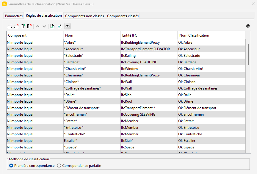

      It looks like your classification rule for ifcSlab is limited to elements that have Dalle in their name. Is this the case for the unclassified elements?
