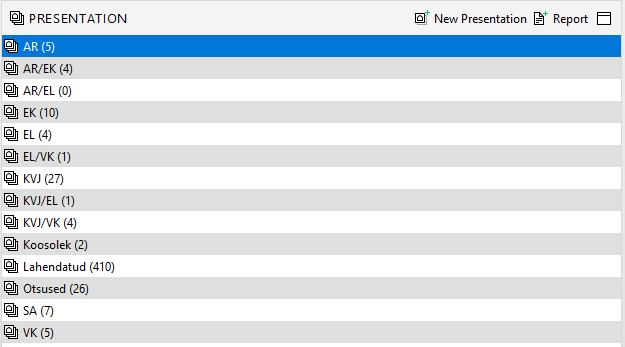

      • L Offline
        L Offline
        lraimo
        @Matti-Kannala
        I would like to report rejected Checking results count to excel like this
        Also would like to report Communications presentation slide counts by presentation name and group by Responsibility
        Alex.JA 1 Reply Last reply

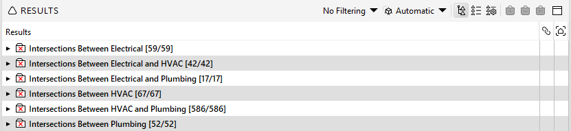

                • Alex.JA Offline
                  Alex.JA Offline
                  Alex.J
                  replied to lraimo on last edited by
                  @lraimo said in BCF in ITO?:
                  I think we have a similar request, if not the same. We want to be able to report results by a predefined custom hierarchy.
