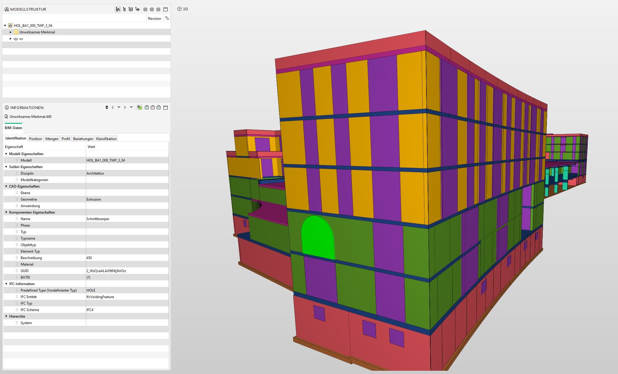

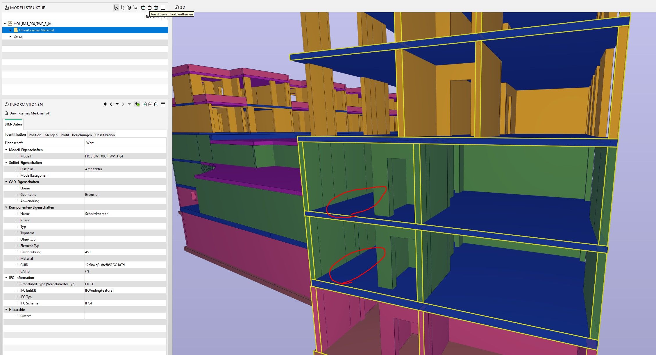

    Hello everyone,
    in one of our projects the civil engineers are using the software TEKLA and create openings (in walls and slabs) by modelling IfcVoidingFeatures. Those IfcVoidingFeature elements are supposed to create openings. When I open the IFC file in Solibri all IfcVoidingFeature elements are put into a special container outside the usual IFC structure and I can see the elements.
    So when I hide the IfcVoidingsFeature elements, the opening only appear in the walls and not in the slabs.
    I also checked the visibilty of the openings in BIMcollab Zoom and BIMvision - no problem there
    Has anybody every heard about that problem before and can help me out?
    Thanks!

        Thanks @paola-bronzo for the advice! I just updated the software - the IfcVoidingFeatures disappeared. But unfortunately the openings are only visible in the walls…
          There is a simple fix. We try get it to the next release.
