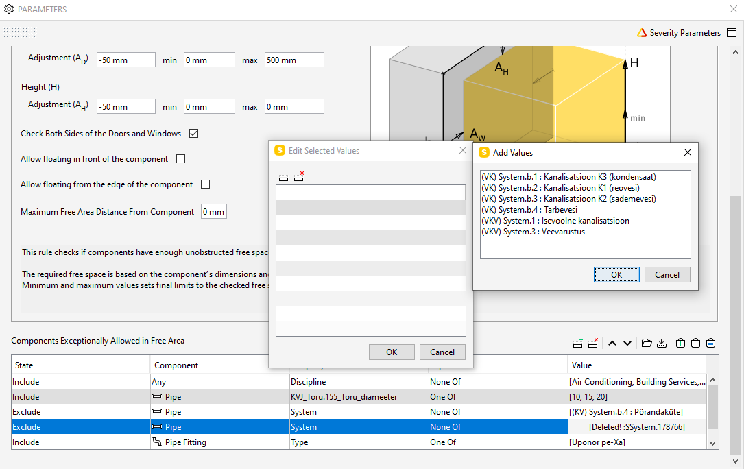

    Found a bug with rule SOL/226/3.1
    When model is updates then System gets value “[Deleted! _SSystem.178766]”
    Cant add system to that row because it is not present in the list
    When I add new row then it is present
    It does not happen every time and seems that when model is closed and open up again the also system is present in the list

        One workaround for this bug would be using system classification and filter based on classifcation.
