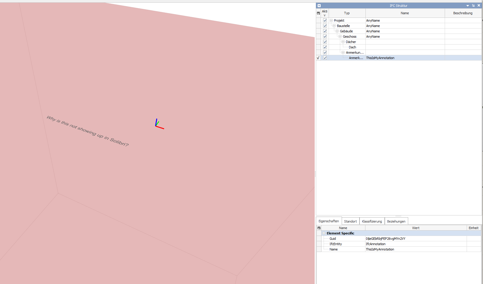

    Why are annotations still not showin in Solibri?
    AnnotationTest2.ifc

        Hello!
        Thanks for the message. Currently we’re not really supporting any 2D elements within ifc models, including annotations. This topic has come up internally as well as from users quite often, we’ll prioritize this and aim to deliver before the end of the year.

          @tonigyllenberg Hello Toni
          That sounds great, thanks for keeping us up to date 👍
