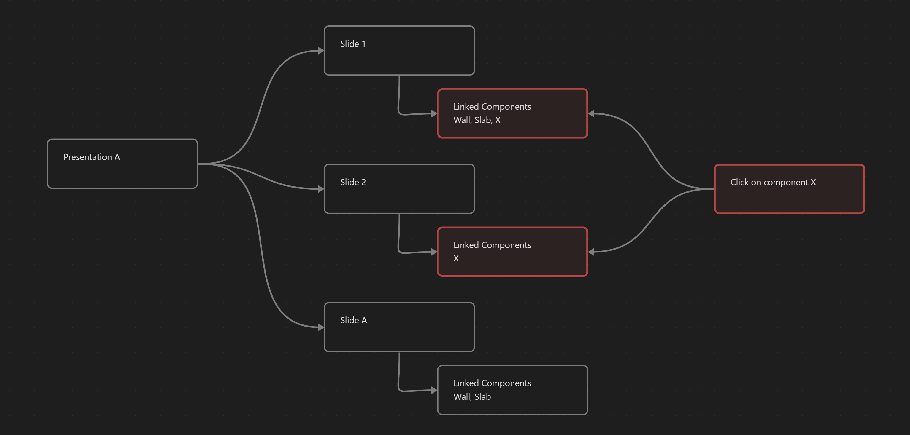

  3. I want to click on a component and see which (imported) presentations have slides with ties to it...
1 Posts 1 Posters 410 Views
    … but how?

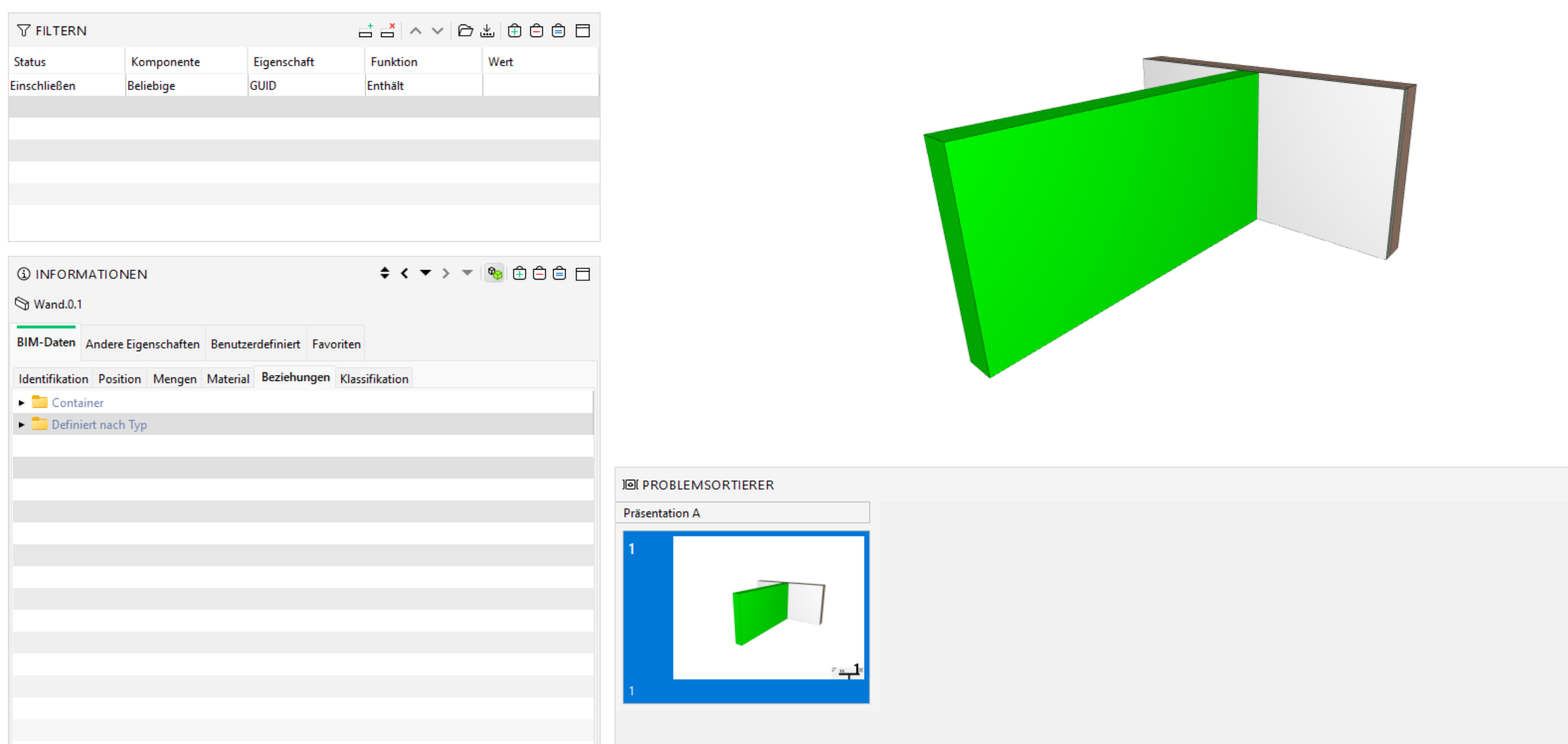

    Example:
    Is there a native way to achieve this?
    Using API, I guess I can iterate all slides and search for slides using the getComponents() method but is there also a method which helps me to set and “jump” to the relevant slide(s) in the issue sorter? What does setStage() do? But then again what happens if there are multiple slides in question?
