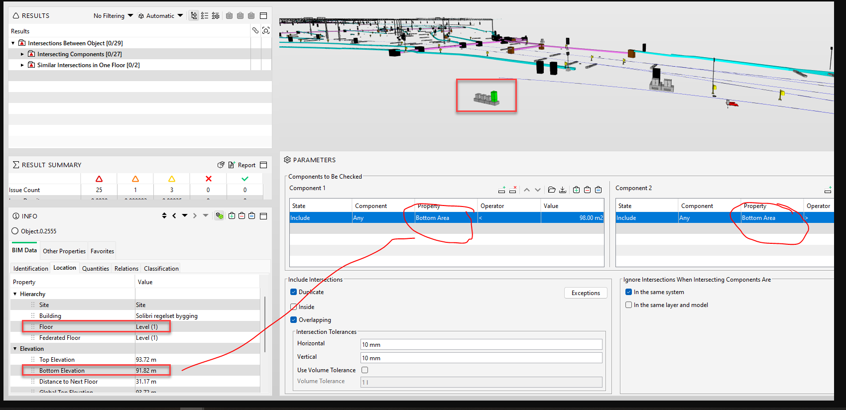

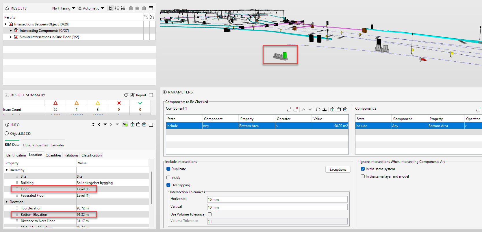

    I am trying to build up a control of objects that is between a height of 98m and 110m in the model, all objects is on the same level in the model.
    As in the picture i got some objects that is much lower then they should be, these should be on the same bottom elevation as the rest the same type of objects at around 98m
    And the same i got some objects that are flying mid air, that should have a bottom elevation of 98m.
    Is there a better rule then this “General Intersection Rule” i can use or modify it so i don’t get only the objects that have some sort of collision as the flying object don’t got any collisions it wont show up?

      You ask to check the heigth, but in the rule you use Bottem Area?
      Select the Bottom Heigth in teh ruleste and see if it works.
      Maybe yo can use the rule SOL/231/1.7

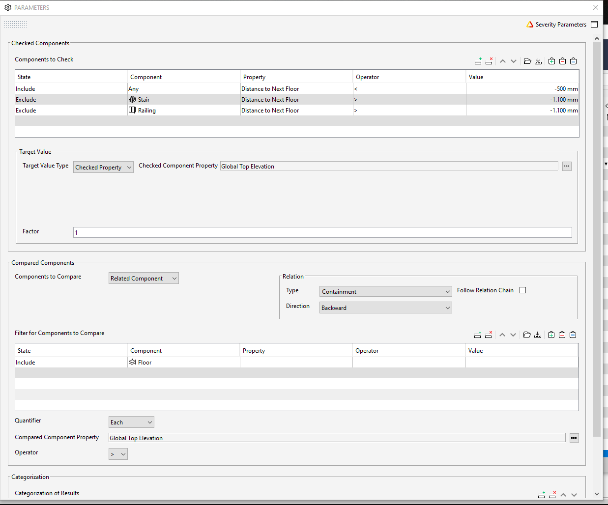

        Thanks for the answer and sugestion Harmen, i will try that next time.
        I got it working as i wanted with the SOL/230 rule and a classification to support the rule.
