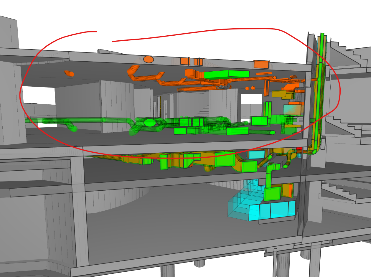

    This (the displaced wall) should not happen.
    Solibri - Showing me this after the Model Update:
    Side Note: It only happens in when I am updating my model in the project specific .smc where this model has already been added before. Totally removing and adding it seems to resolve this issue. Still curious why this is happening? I am not aware of a possibility to move singel components either, so could not say that there has been any manipulations made in the past which would explain this behaviour.
    All other Viewers … but also if I open the IFC in a new Solibri instance:
      wrote on last edited by JSN
      It keeps on happening. Seems like the models don’t migrate well …

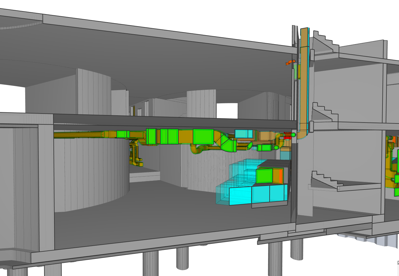

      Completely messed up geometry on model update …
      vs. a fresh loading …
      … causing lot’s of confusion. Due to that we have to double check modells in other tools as well - we can’t rely on Solibri at the moment.
