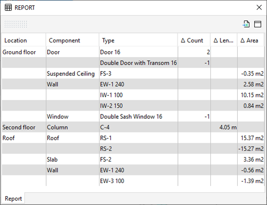

    I got a bit confused about the report of the results of the Component comparison rule.

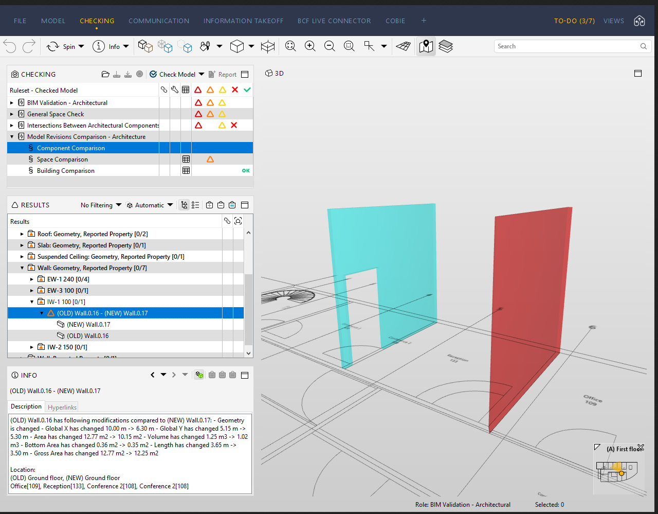

    According to the report I would assume, due to the ΔArea column, that wall: IW-1 100 got 10.15 m² larger in comparison to the old model.
    But according to the description of the result the wall: IW1 100 changed from 12.77m² to 10.15m², which would mean the ΔArea would be 2,62m².
    I suppose that the column description is just misleading?
    Is there any way to get the actual deltas of the values and not just the new value?
