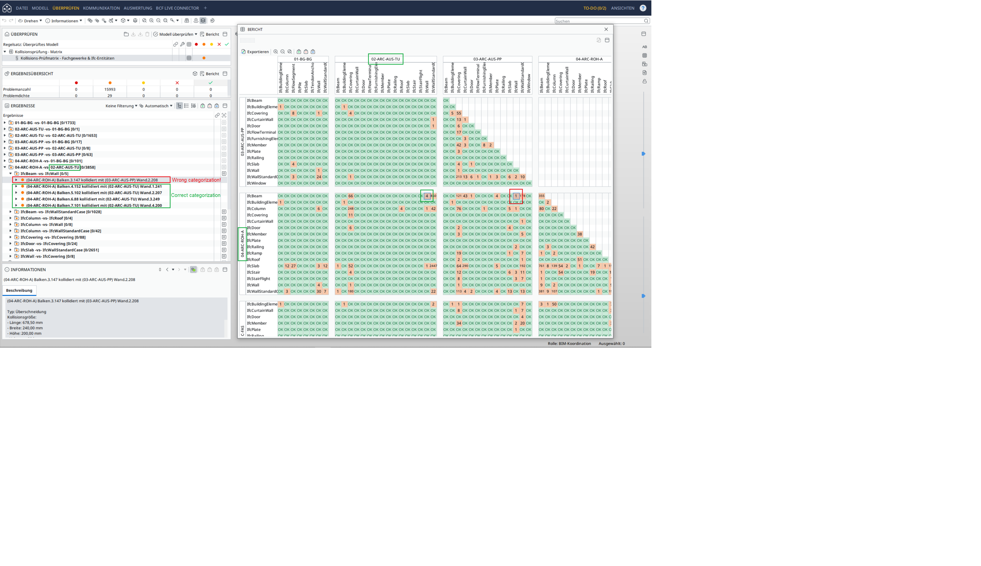

                    I have recently updated to version 24.12.0.44 and I am still experiencing a false categorization of the checking results. See screenshot below.
                    My matrix is organized under models (short name) as first layer of hierarchy and Ifc Entity as a second layer. It seems like Solibri does not allow any repitition of results categories, for example, there can only be one category of clashes that are called IfcBeam -vs- IfcWall, and if instances of this category happen between other models, the results are categorized to the first category created, even if it exists under other models from the matrix.
                    Is this a bug or is there a workaround for it?
                    I am really looking forward to having a solution to this problem.
                    Thanks!
