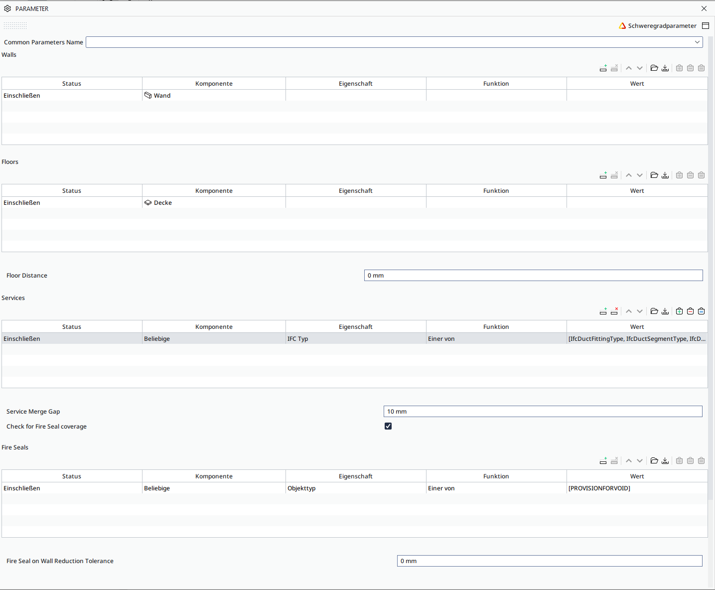

    does anyone else experience that the fire stopping identity rule (SUK/1002/2.2) is extremly slow/ does not finish at all?
    I even tried it with just a few selected objects but the checking never finishes.
    Are there any further settings which I miss?
      simon.gilbert Solibrians
      I see that you have all walls and all floors in your filters. How many walls and floors are in your project? Although all walls can be set for the filters it real design was for compartmentation walls and floors. We would have to have a look at the files in question. Please can you log a support issue related to this and we will investigate further.
