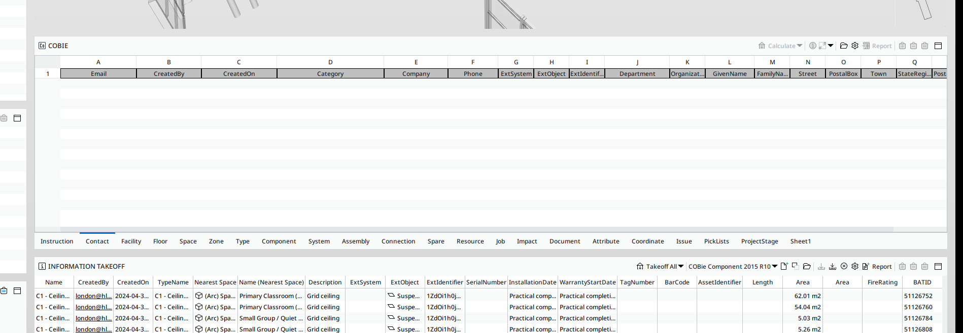

    Issue as title above, I have ran my takeoffs for all applicable sheets in COBie report but “Calculate” on my COBie sheet is greyed out. Any ideas?

      Hi, This is a known bug and is logged to be fixed. The COBie project has to be the first project opened once Solibri is started otherwise this happens. Simply close the project (save if required), shutdown Solibri and then restart Solibri opening the same project, load your COBie settings and the calculate button should now be available.
