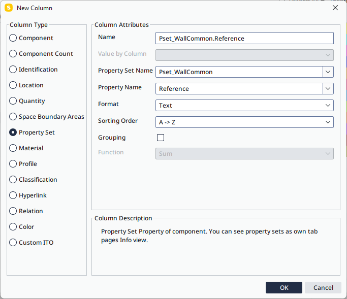

    I would like to know if it is possible to create an ITO where I can check all the property sets and the properties contained within each property set.
    Thanks!
    M.
    • jakub.rusinJ Offline
      jakub.rusin Solibrians
      Hello @Maria-Martinez and thanks for inquiry.
      Could you specify more what would you like to achieve exactly? I am confused by the word “check”. You can check PropertySet and Porperties with rule #203 Required Property Sets:
      This rule checks that the model contains required property sets and properties. It can also checks that the properties have (or don’t have) a value and the type of the value is acceptable.
      In ITO you can set up a ITO column to have a PropertySet:
      Or are you just trying to get a list of all PropertySets and Properties within a model? For a specific IFC Entity?
      M 1 Reply Last reply
      • M Offline
        M Offline
        Maria Martinez
        replied to jakub.rusin on last edited by
        @jakub-rusin I am just trying to get a list of all the PropertiySets and properties within.
        JSNJ 1 Reply Last reply
          replied to Maria Martinez on last edited by
          @Maria-Martinez This should be possible with a JavaScript column - depending on what you want to achieve.
