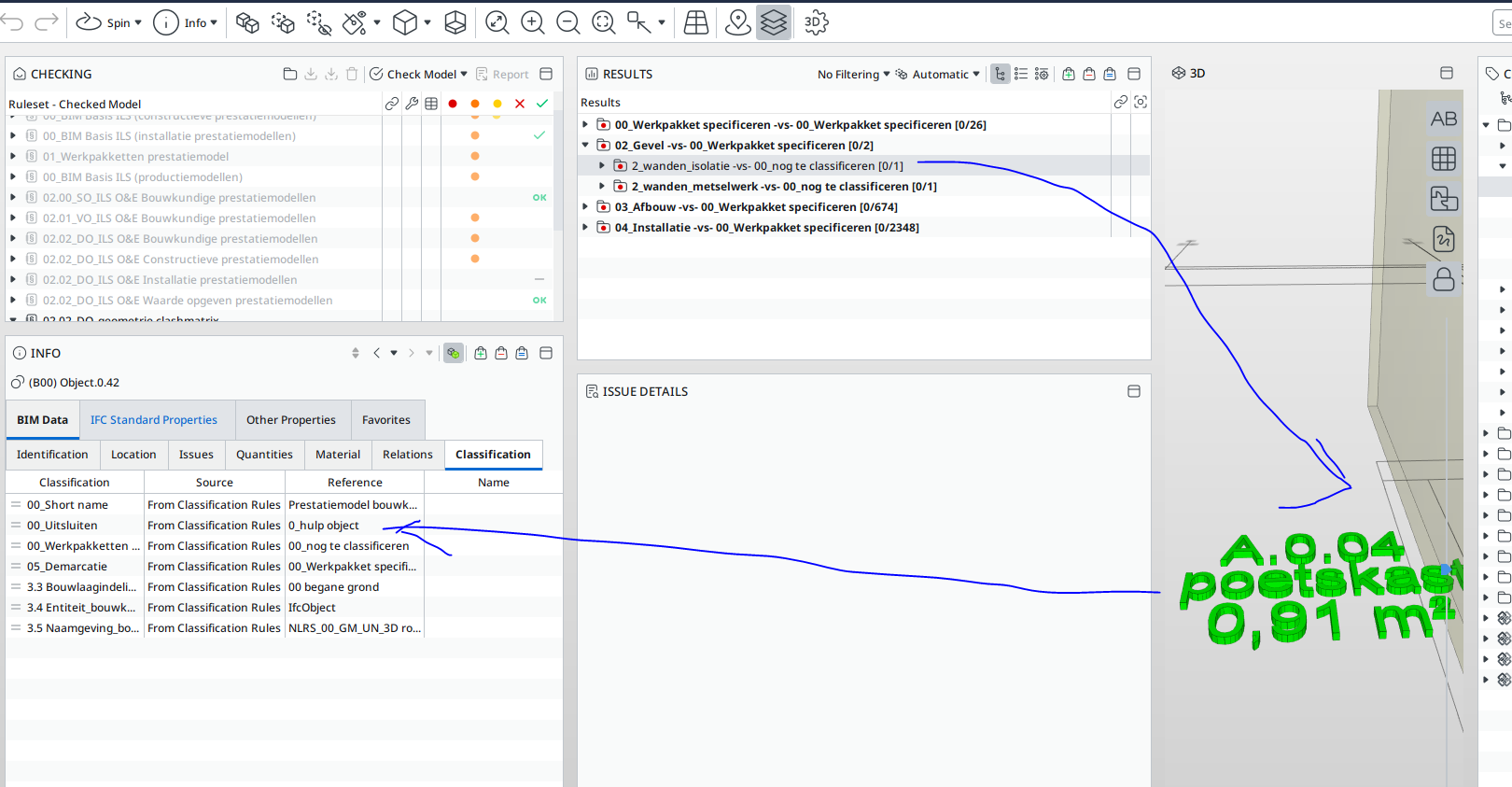

    clashmatrix_exclude openingobject.png Clashes with openings en spaces still represented in clash results despite i’ve exclude in this this object in componentfilter that is build in the clash matrix.
    Is this not working properly or am i doing something wrong?

        @Harmen-Jorritsma The method you describe works fine for the amount of clashes in de report. But this won’t work for indicated clashes in de results, there’s needed to use filter the rsults afterwards by selecting everything exept openings and spaces. I was expected filtering afterwars isn’t nessecerry because it is excluded in the first place. ![alt text](clashmatrix_exclude openingobject2.png image url)

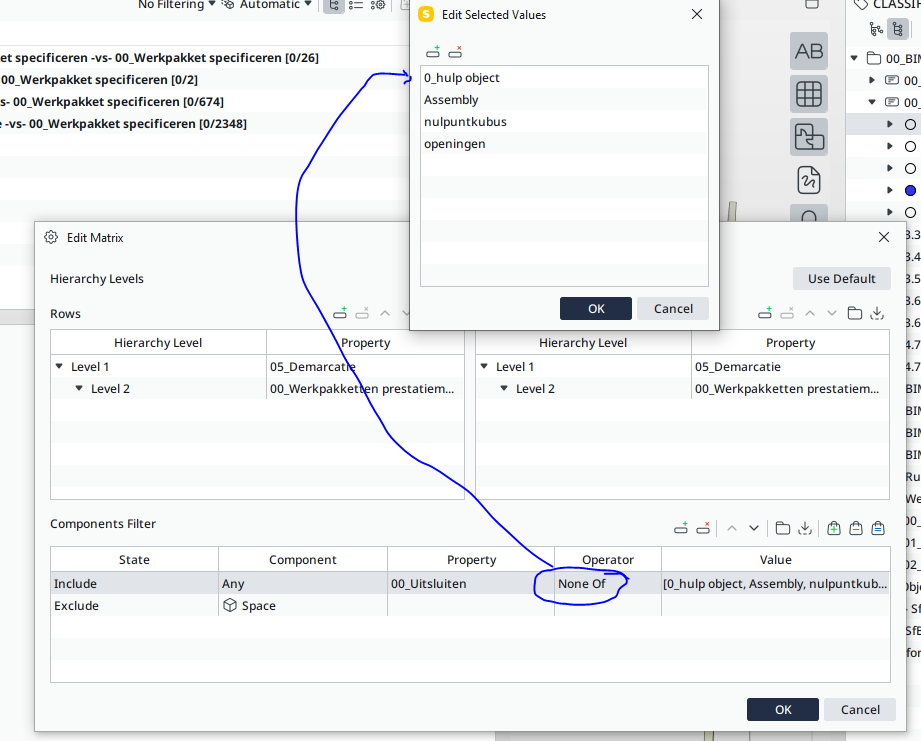

              I sent you a file wit we transfer. I experiance this that the component filter not work.
              I exclude the _hulp object, but the result of the matrix shows a clash?
