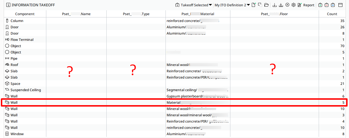

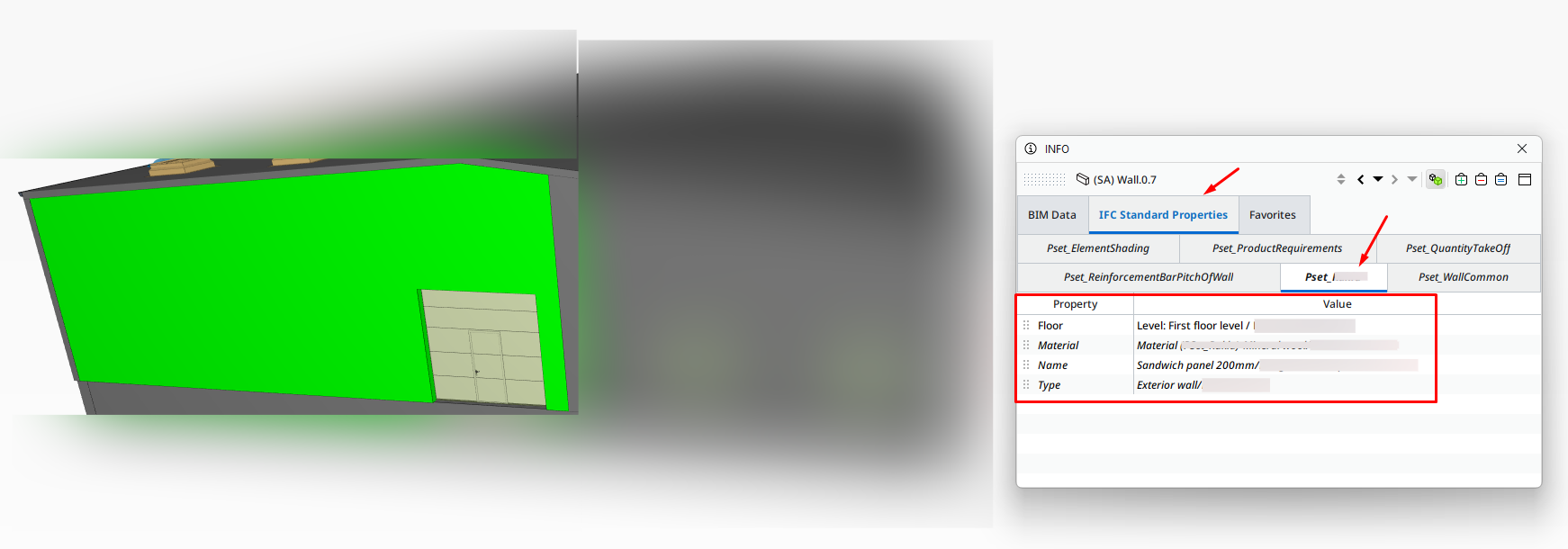

    Hello,
    Have an issue where I can’t see the values of parameters that are placed in a custom Property Set while using Information Takeoff. I can see all the values when I select an element and check Info but once I try to use Information Takeoff, only the values of one parameter (Material) are visible. Others are blank (even though they are filled, as I said).
    Checked in BIMcollab and it works there. All the values are visible (using Quantity Takeoff)
