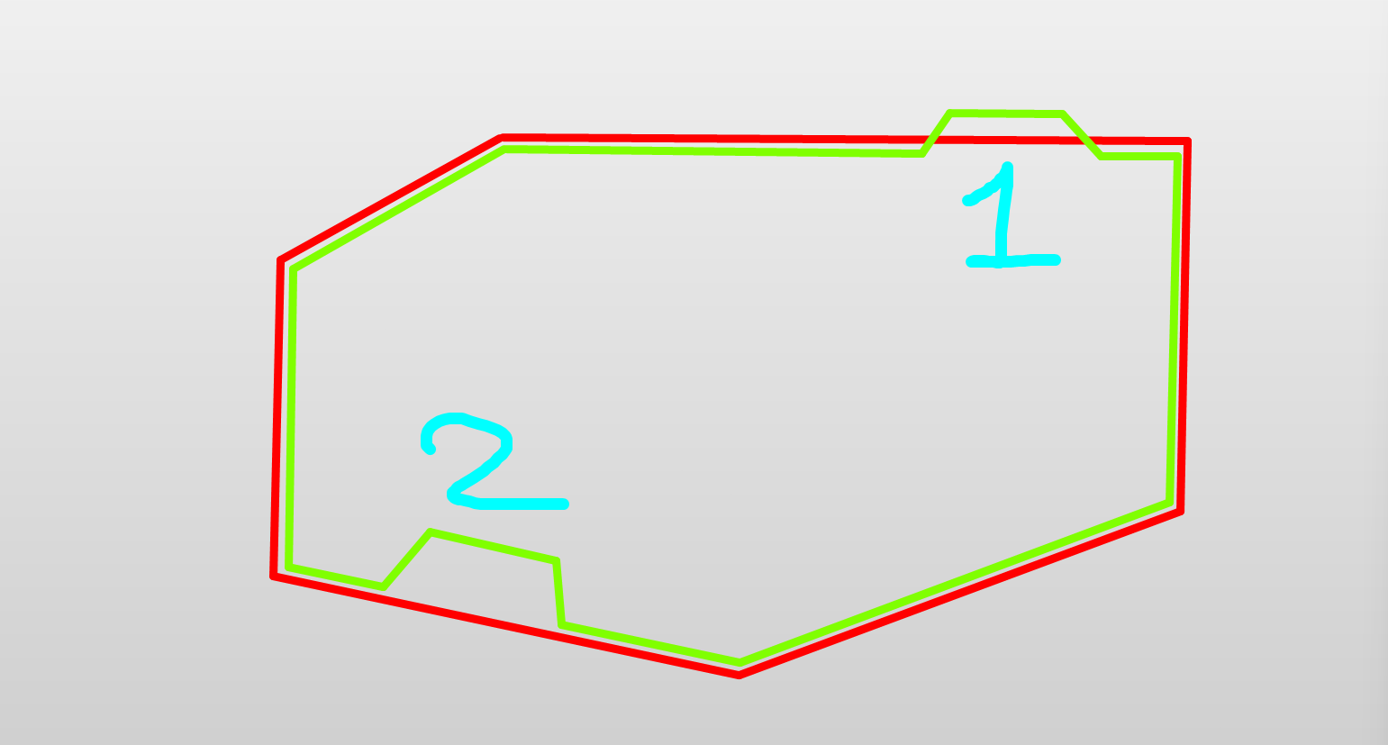

    I have a model that represents site (green). I have as well a model that represents legal site border(red). Red model are just walls. Site model has many elements.
    I’d like to know where site does not comply the legal border. There are two cases - border overlaps (1) and border does not reach (2) legal border.
    Which rule would your recommend for such check? Thanks.

        Great idea, however, We use this model as well for visual proposes and your CDE wouldn’t be happy with super big volume with everything inside.
        I was wondering if there was a way to take all elements and get precise floor plan bounding box. I was experimenting with element distances for IFCsite, but IFCsite it not an element according to solibri 😕

            In any case, I understand how to check if the site modeled beyond the legal border as one big volume (if anything is outside the volume it’s a problem/issue).
            But how do you check If the modelled side does not reach legal border (2 number in the picture)? The site model itself contains a lot of separate 3d surfaces that together makes a site model

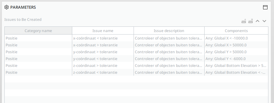

              Maybe you can use teh rule SOL232/1.1
              https://help.solibri.com/hc/en-us/articles/1500004610841-232-Manual-Checking-Rule
              You can set the borders in the ruleset.
