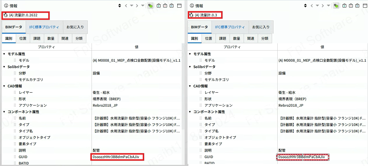

    I just realized that component’s name changes after reopening the IFC file:
    I searched component with GUID, closed Solibri, then reopened Solibri with IFC file and search again with same GUID. The name of component has been changed.
    Can you explain for me? Maybe it causes of IFC file.

      The name that you see is constructed in Solibri. I assume that the component on the left is in a project with multiple IFC files and when you open the file alone it has a different name. Does the name change, if you open the IFC file, close it, and open it again?

        @Pasi-Paasiala The name changes when I open the IFC file, close Solibri not the IFC only, and open it again

          This looks like a bug of some sort. If the ifc file is exactly the same the name should stay the same. Can you send that ifc file to support?
