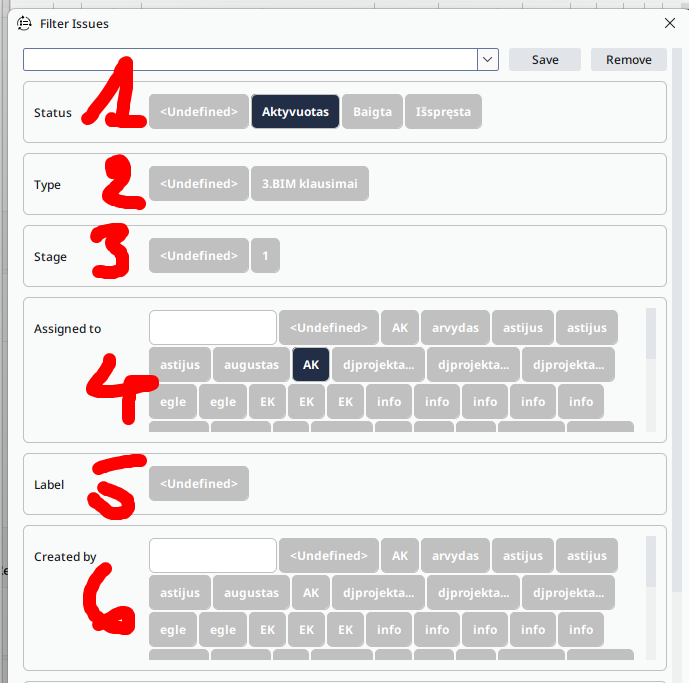

    Hello, in newest solibri version filtering issues from Dalux works not as intended.
    If I would like to sync only the issues that are assigned to me and are active I would use 1st ir 4th parameter with dedicated values.
    However, Solibri uses OR operator and that means it syncs issues that math at least one parameter value. That leads in getting way more results than intended. I have contacted Dalux and they reported that it is a solibri problem.
