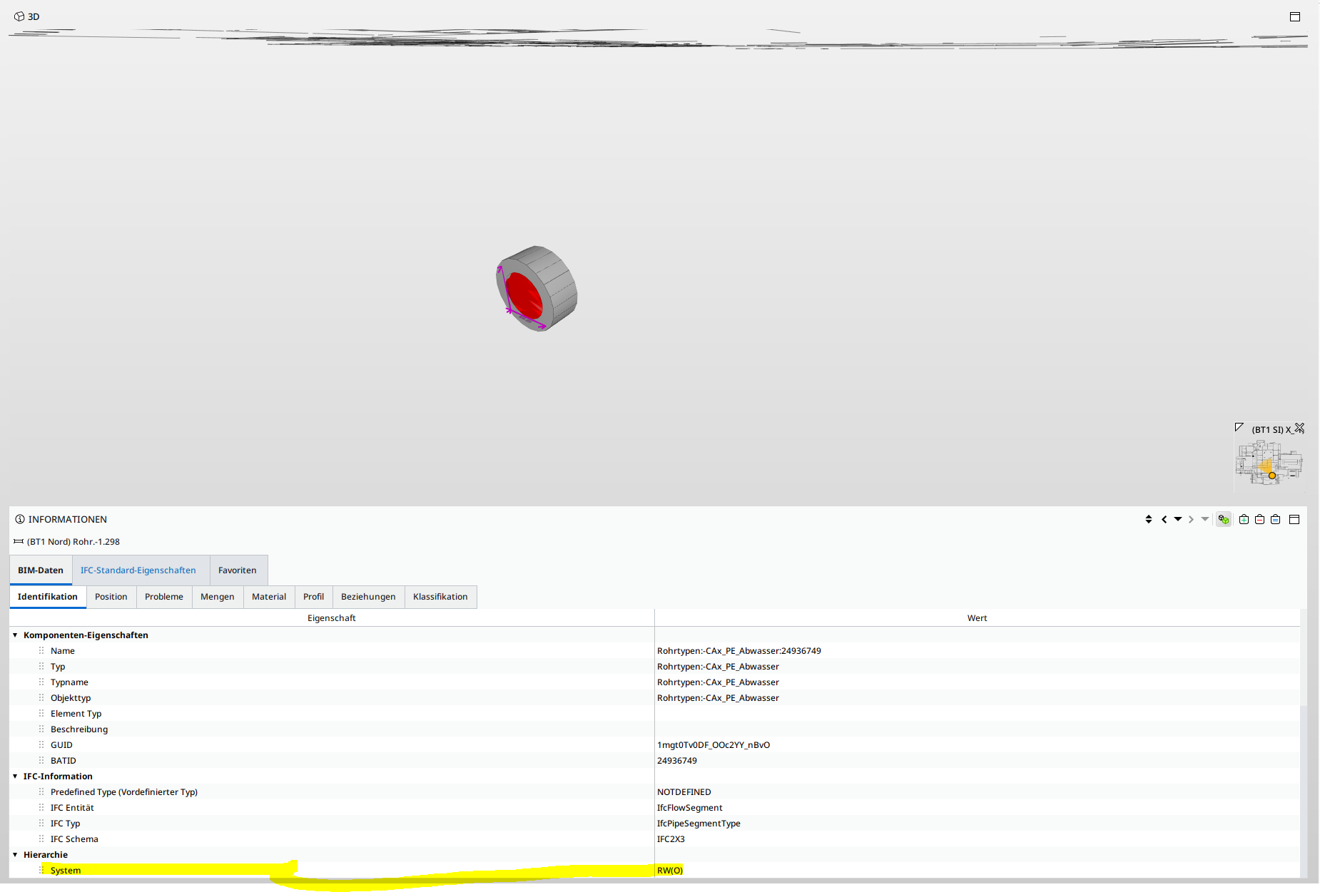

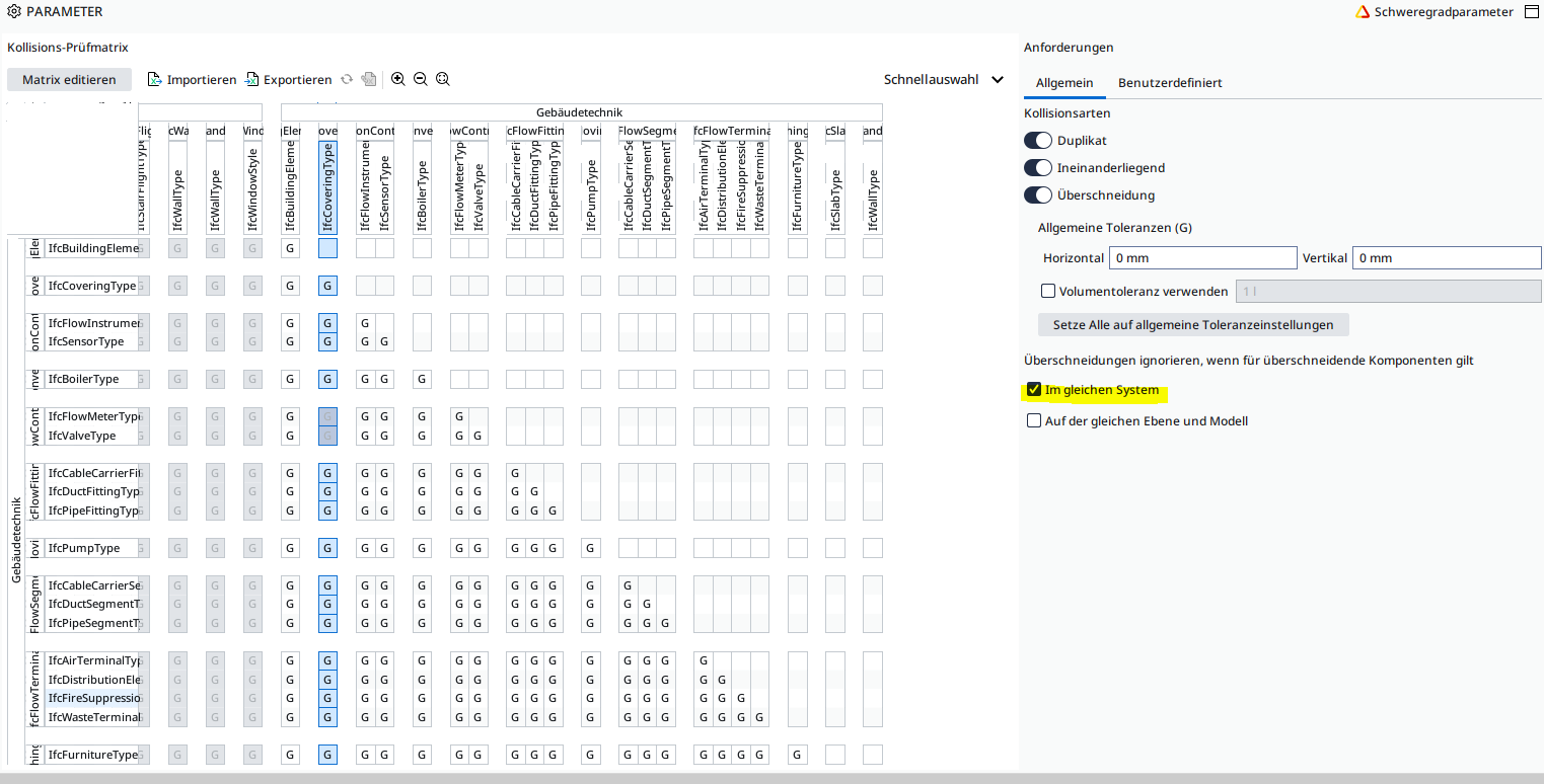

    Hello there,
    I noticed that the clash matrix rule SOL/245/1.0 has the option to ignore clashes when the components are in the same system. But even though I have the option activated the results return clashes for them. Unfortunately now every pipe, pipe segment, etc. that is insulated returns a clash.
    When using the standard clash rule SOL/1/5.0 these components are ignored.
    Is this a bug in the clash matrix rule or are there any more options which need to be regarded in order for the rule to work as expected?
    Option ignore when in same system is on
    But the result gives back that the pipe and the covering have a clash even though they are in the same system
