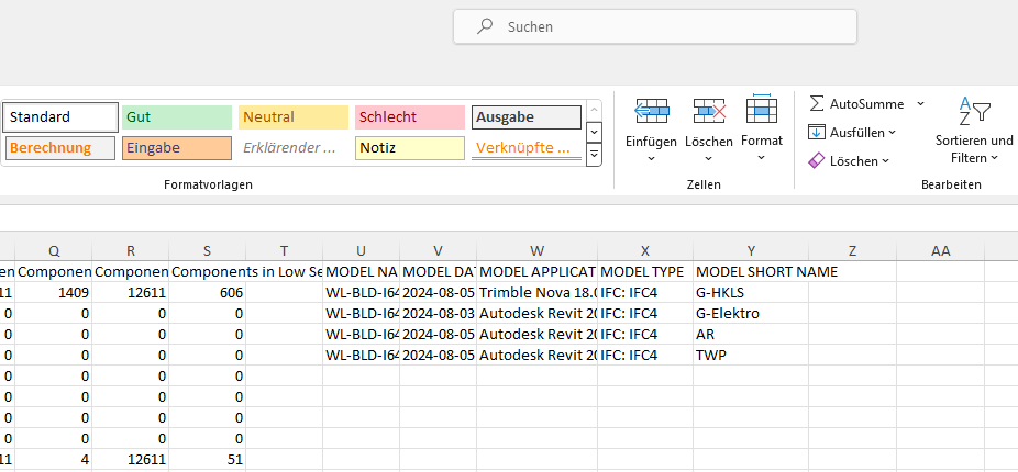

    What seems to indeed do the job after lots of trial and error is …
    • to either open the .smc file in the previous Solibri version and export the report from there.
      or
    • to remove on specific model from the file and now the export seems to work - needless to say that this is not a real workaround.
    What causes this problem?

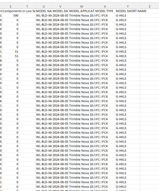

    However, if I compare the two exports of the above mentioned “solutions” there is also this “new” undesired behaviour of listing model data …
    Good (Exported as usually with the previous Solibri version)
    Not good (Exported from build 24.05…) after removing the model which prevented the report at all)
