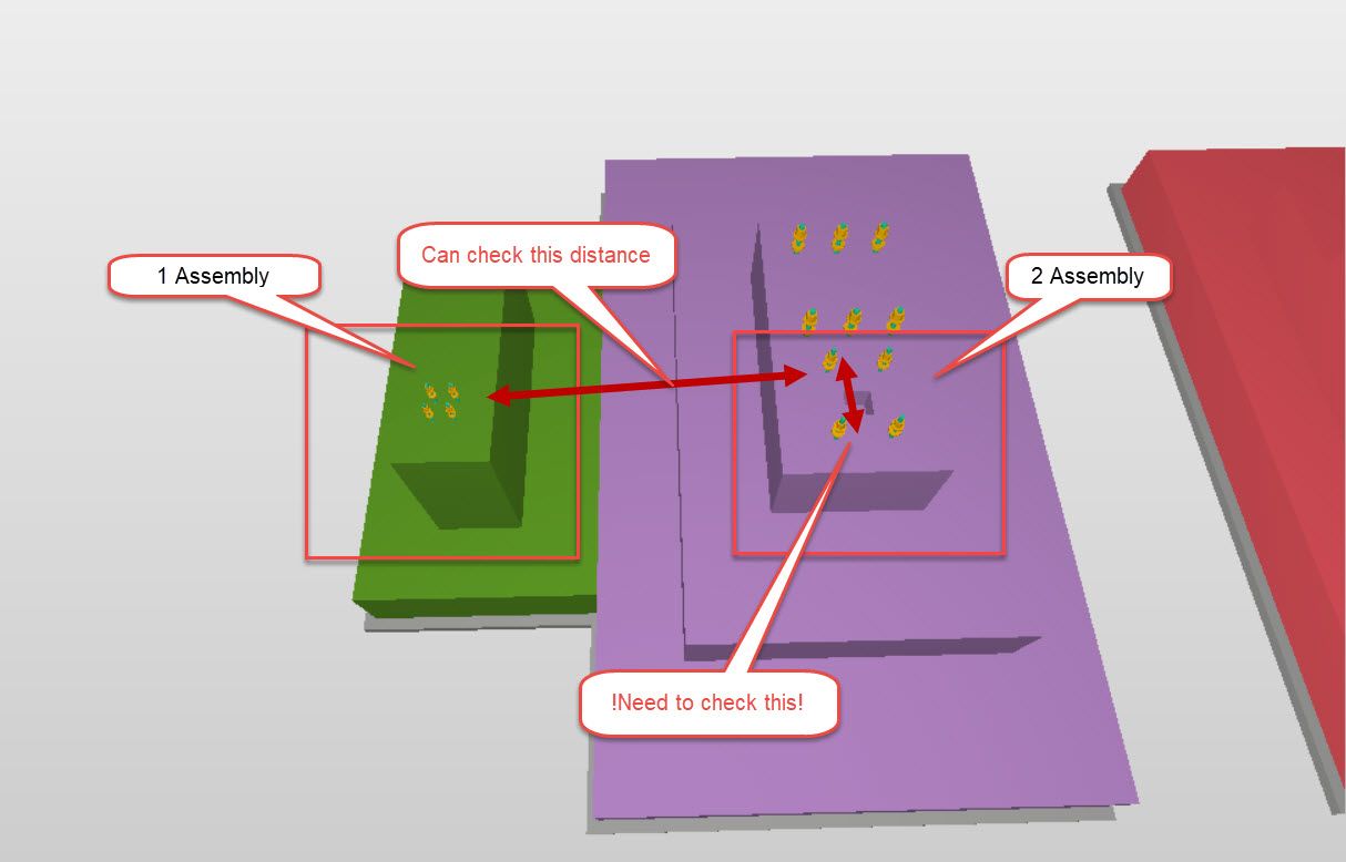

I have an idea to check the distance between components in an assembly, but the Rule #222 checks only components in different assemblies.
May be sm1 know how to provide it works? -
I was able to reproduce the issue with the component distance. Unfortunately, I was not able to find a workaround using the various distance method and found the Free Area In Front rule has the same behavior. My tests are in this file attached:
Assembly Test Example.smcPlease send an email to [email protected] so that I may attach your information to the issue logged with our development.
