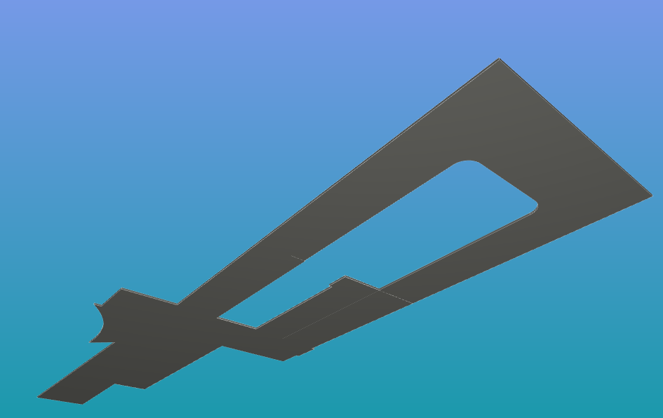

here the Slab is clearly visible

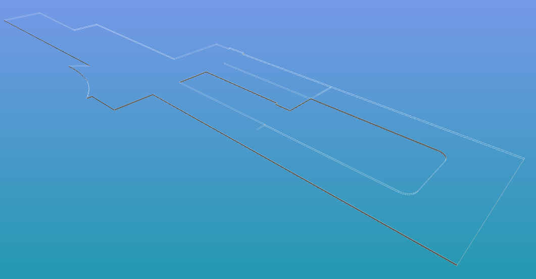

from this angle the slab is transparent

@BvanDalsum said in IFC4 problems with transparancy:
This slab seems to have inverted faces. Might be problem of the IFC file or Solibri IFC importing.

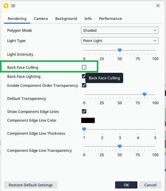

Make this setting OFF to see both sides

@Matti-Kannala , thnx.
it was back face culling indeed.
Normaly i leave the box unchecked but this time it wasn’t.Fortunately, it was something simple I overlooked
