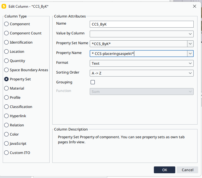

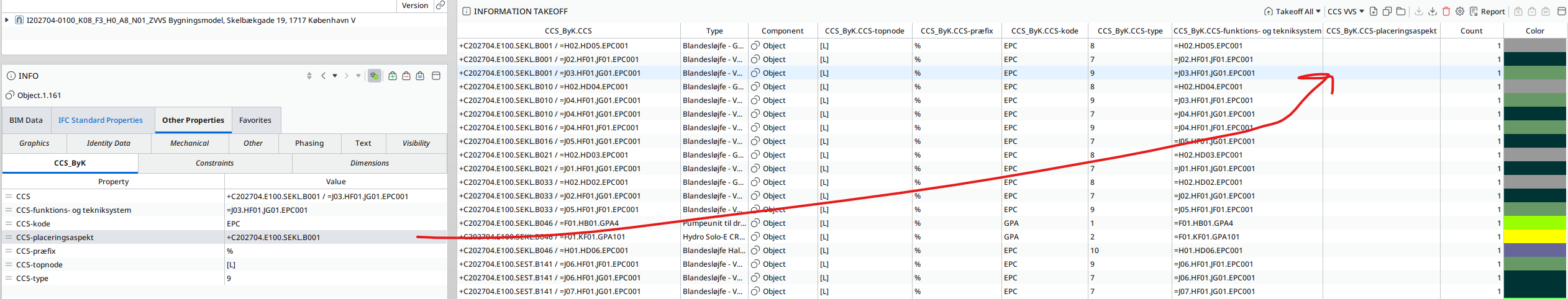

    I’m having trouble getting the CCS-placeringsaspekt parameter to appear in my information takeoff.
    Do you have any idea why the data isn’t showing, even though it’s available?

      Usually this is a whitespace problem.
      Might be possible that there is white spaces either in the property set name or property name.
      To make sure: add stars to the ITO column fields:

        Thank you Matti, it worked.
