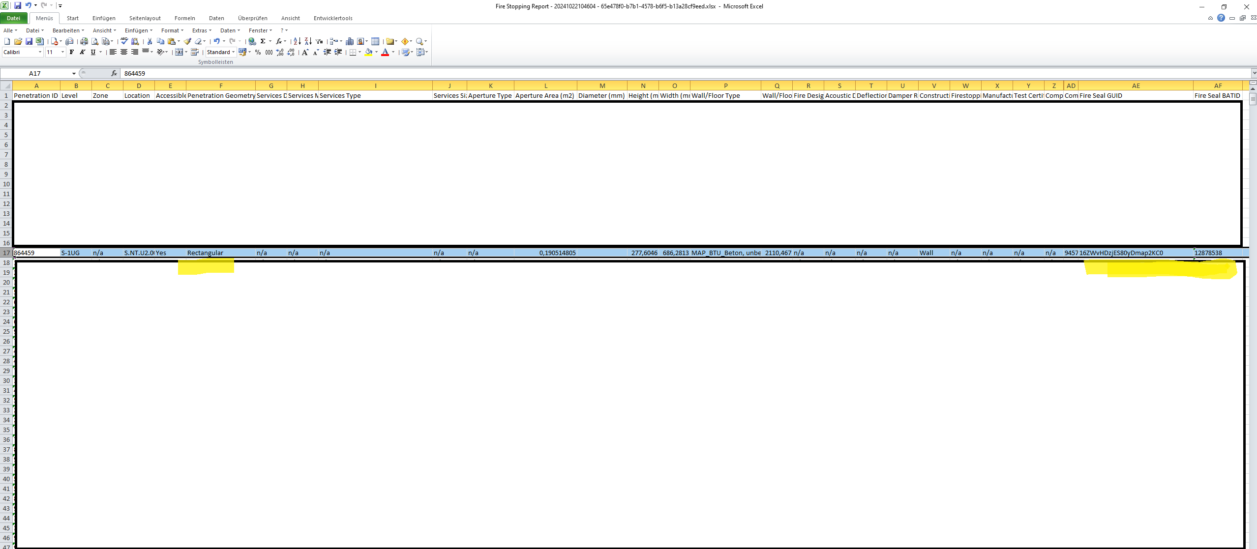

    It seems that the fire stopping report rule is returning faulty reports.

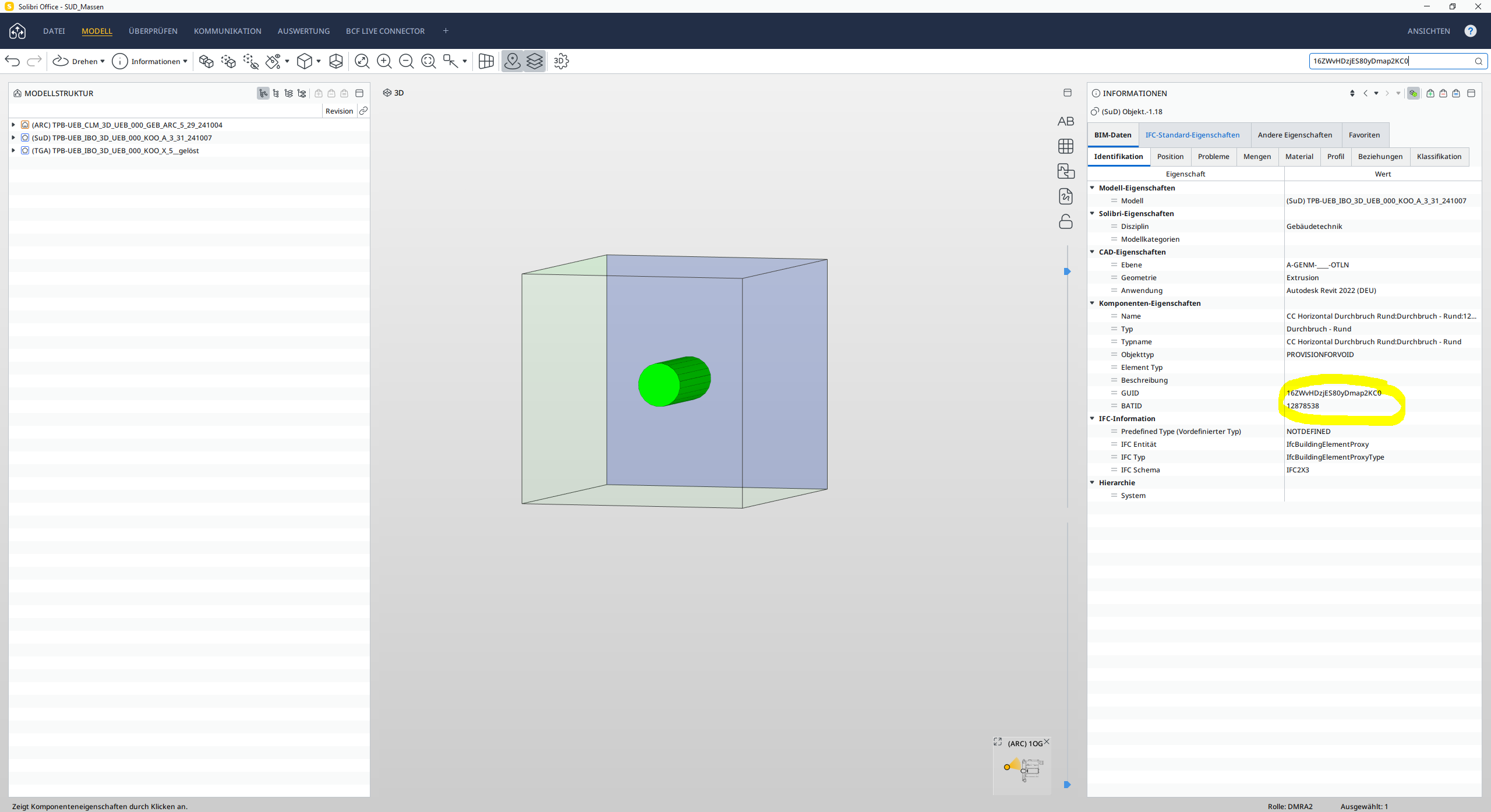

    When looking through the created excel, fire seals are returned as being “rectangular”. But when looking for the fire seal with the guid in Solibri it is clearly a round one.

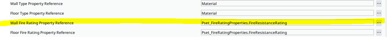

    Furthermore the fire resistance rating of the compartmentations is not filled out even though there is a parameter given in the rule.
    Interestingly some service type descreptions got filled out in the excel but some did not.
    The rule also returned a NullPointerException.
