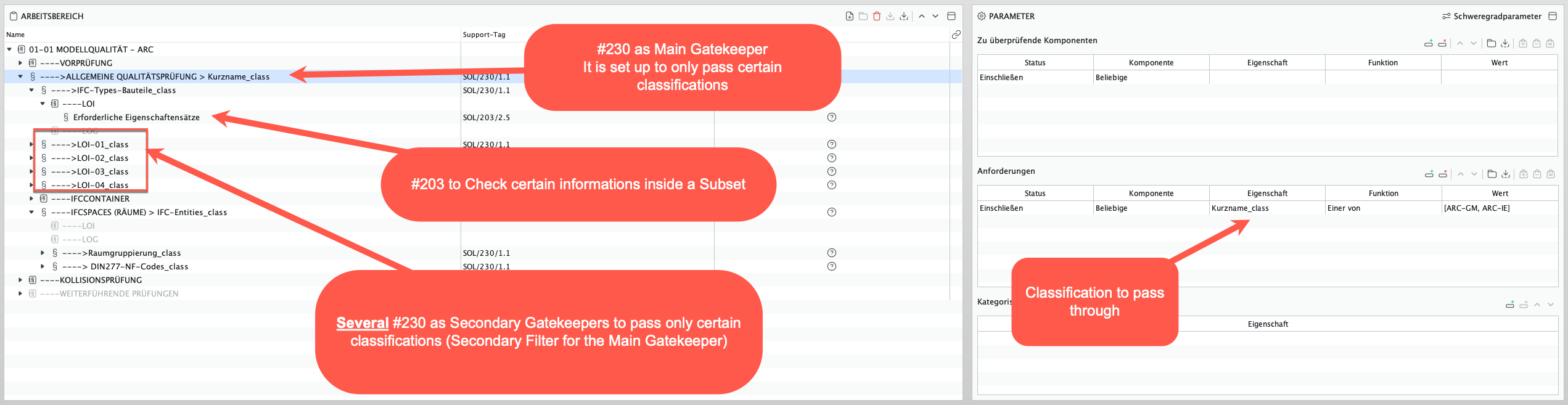

    I try to use a Gatekeeper Set Up with several Sub Branches (Secondary Gatekeeper Rules) in order to filter Models Step by Step and to be able to just change a view Gatekeepers to alter the whole stack below.

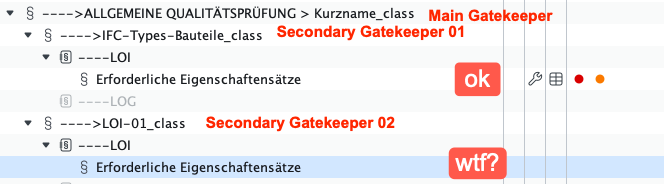

    In my tests it seems though, that as soon as there are more than one Branch inside a Gatekeeper System (One Main Gatekeeper but several other Gatekeepers on the Second Level) Solibri only eratically passes Elements through to one or another Secondary Gatekeeper.
    The Set Up is something like this:

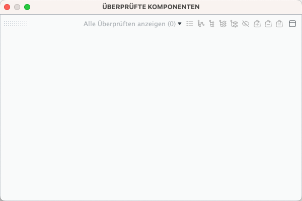

    In the checking Results it seems, that Solibri is only able to pass through to one Subset, all others are empty and there is no checked components Report either:

      Hi @stebehan,
      I remember that there were some bugs involved with interposing a folder between a second gatekeeper (that already comes after a first one) and the “last node” rule, maybe you can try without the “LOI” folders.
      Basically, Gatekeeper > Gatekeeper > Folder > Rule is buggy and should be avoided.
      Here are some setups that do work (using Windows):
      Gatekeeper > Multiple Folder > Multiple rules
      Gatekeeper > Multiple Gatekeepers > Rule
      Gatekeeper > Multiple Folders > Gatekeeper > Gatekeeper > Multiple rules
