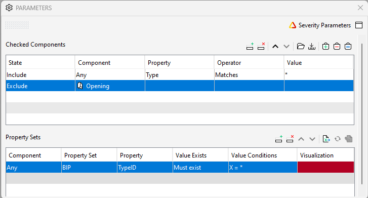

    Is there a way to create a rule that reports which models that have a pset “TEST” lacking for any type?
    Case is I have ten models and I’d like Solibri to report models totally without pset TEST. I don’t want to see an issue for every type in every that lacks pset TEST.
    /Mats
