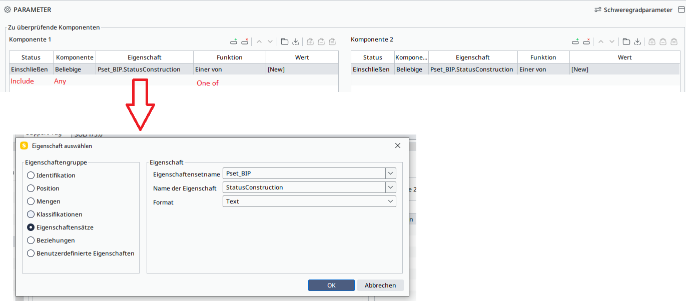

      As I understood the question I don’t think you actually need a gatekeeper rule.
      I think you could use the general intersection rule and check any component with the property set “pset BIP” and the property “StatusConstruction” that is one of “New”.
      A gatekeeper should be possible too but I think this would be unnecessary in this case.
