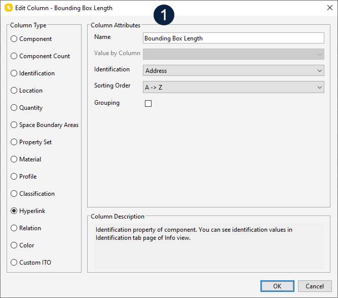

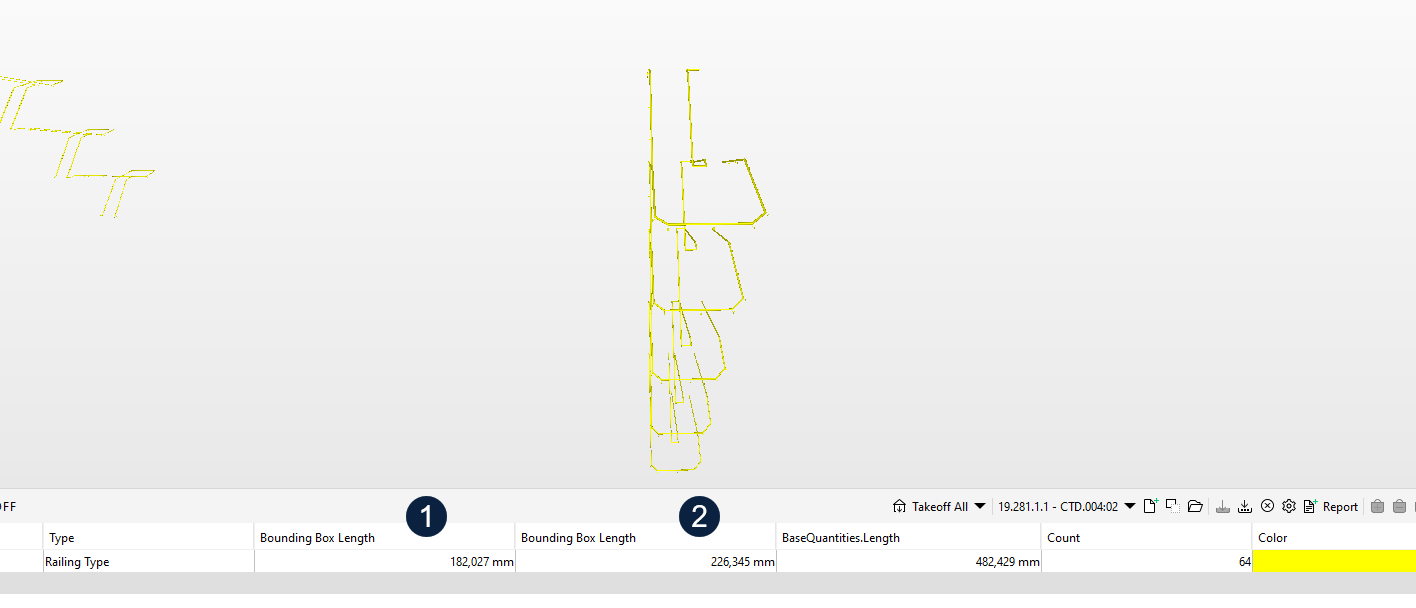

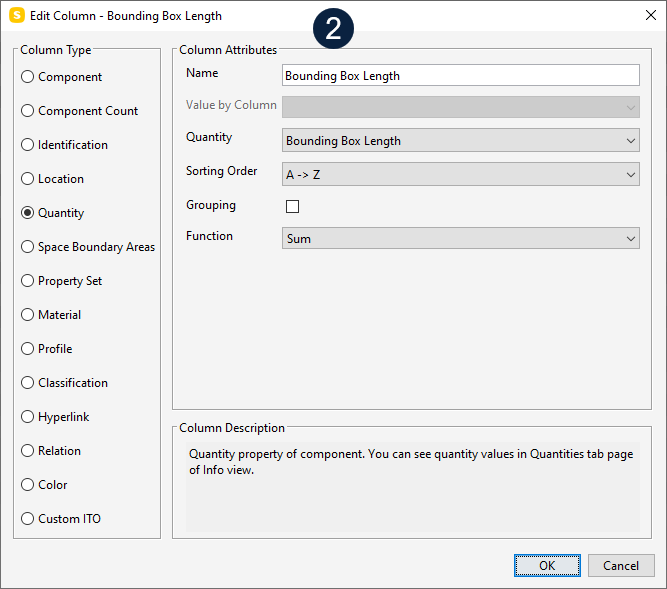

    When I drag and drop the property “Bounding Box Length” in to my ITO, it seems like its connected to “Hyperlinks” and not to the correct property. So when I drag and drop it, it shows me a value different from if I am manualy adding it into my ITO.
    Number 1 in the picture is drag and drop
    Number 2 in the picture is manualy added
    Why is it like this?
    Is it other here with the same problem? Is it a problem with other properties when we drag and drop them into ITO?

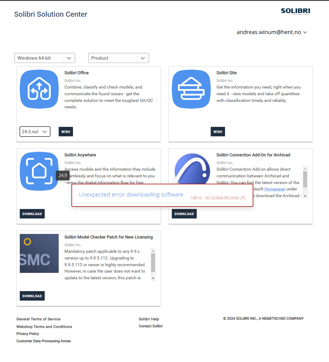

      Which version of Solibri you have? I think this is fixed. I could not get this with the latest version.
      • A Offline
        A Offline
        Andreaswinum
        wrote on last edited by Andreaswinum
        I do have 9.13.6.15, but when i go to Solibri Solution Center i get this pop-up
