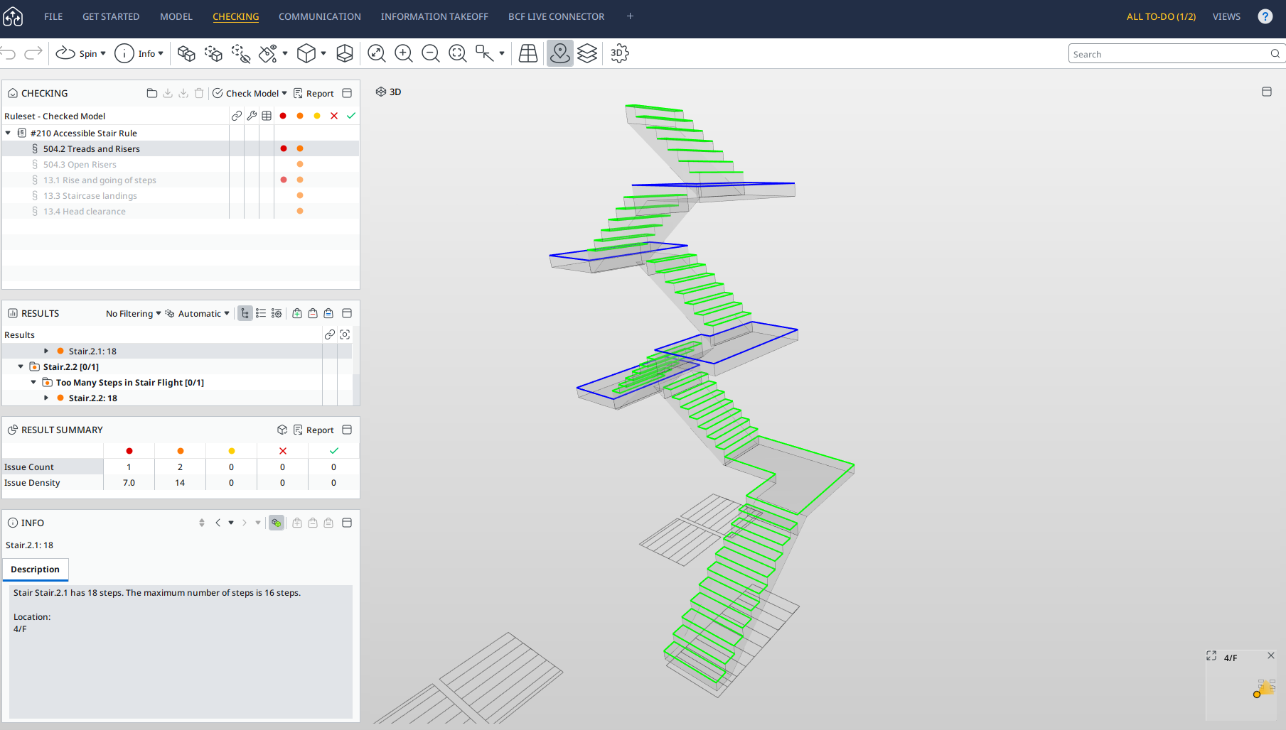

    Hello Solibri community,
    I have a question regarding the Staircase Rules Checking (SOL/210) in Solibri. While reviewing the results, I noticed something unusual with the way the riser count is being calculated.
    Specifically, for Stair 2.1, it seems that the 1st flight and 2nd flight’s riser numbers are being counted together, including the landing. This has caused some confusion, as I was expecting the flights and landings to be evaluated separately.
    Has anyone else encountered this issue? Is this the intended behavior of the rule, or could there be a setting or configuration I might be missing? Any guidance or clarification would be greatly appreciated!
    Looking forward to your insights. Thanks in advance!
