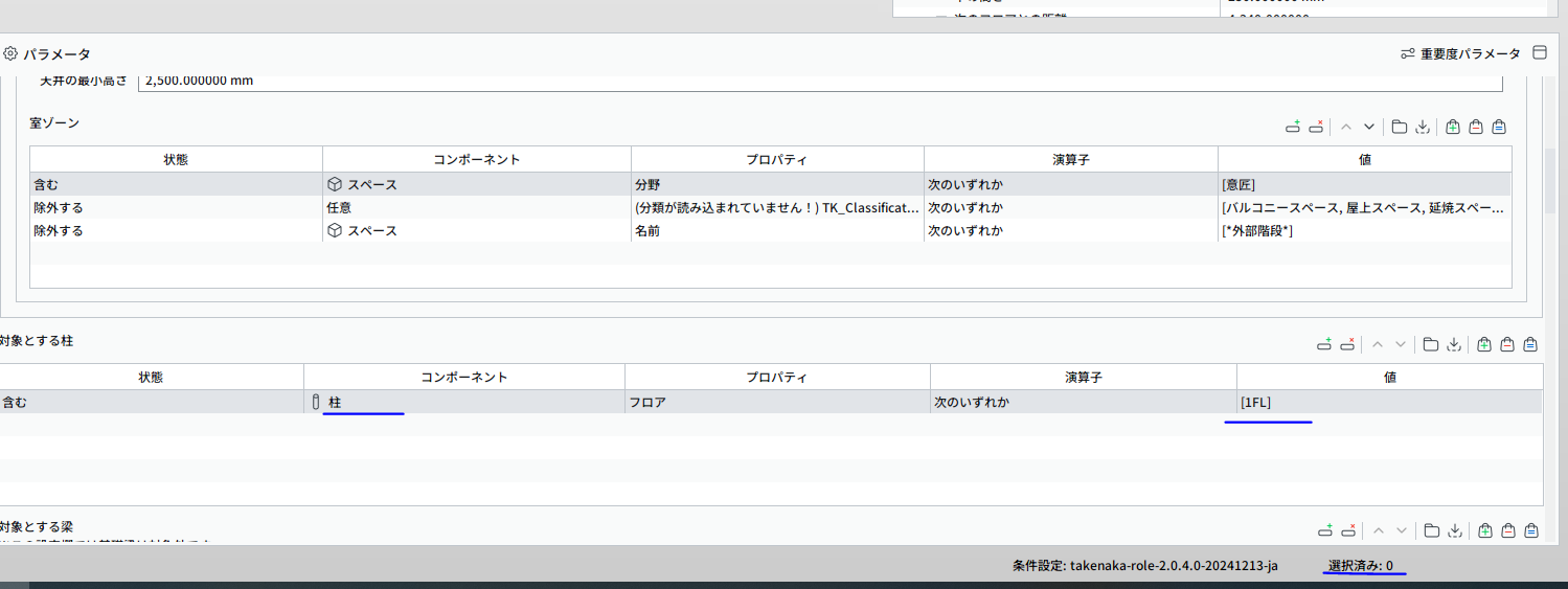

    Hi @Solibrians, after update to v24.12, filtering components by floor is not working correctly

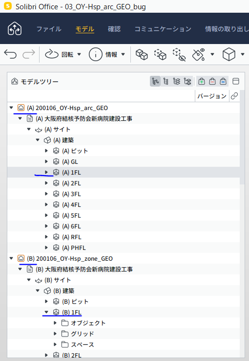

    These models have 1FL
    But I couldn’t get the components by using floor filter

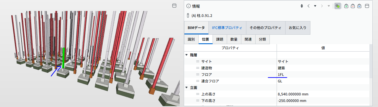

    Model (A) has the columns at 1FL
    Maybe the filter is using model (B)'s 1FL not the model (A)

      Try to remove the filter row and add it again.
      • For the old filter rows Solibri 24.12.0 filters floors using the model shortname. This is for compatibility with old filters.
      • For the new filter rows Solibri 24.12.0 filters floors using the name without the model shortname.

        I try and it works, thanks @Matti
