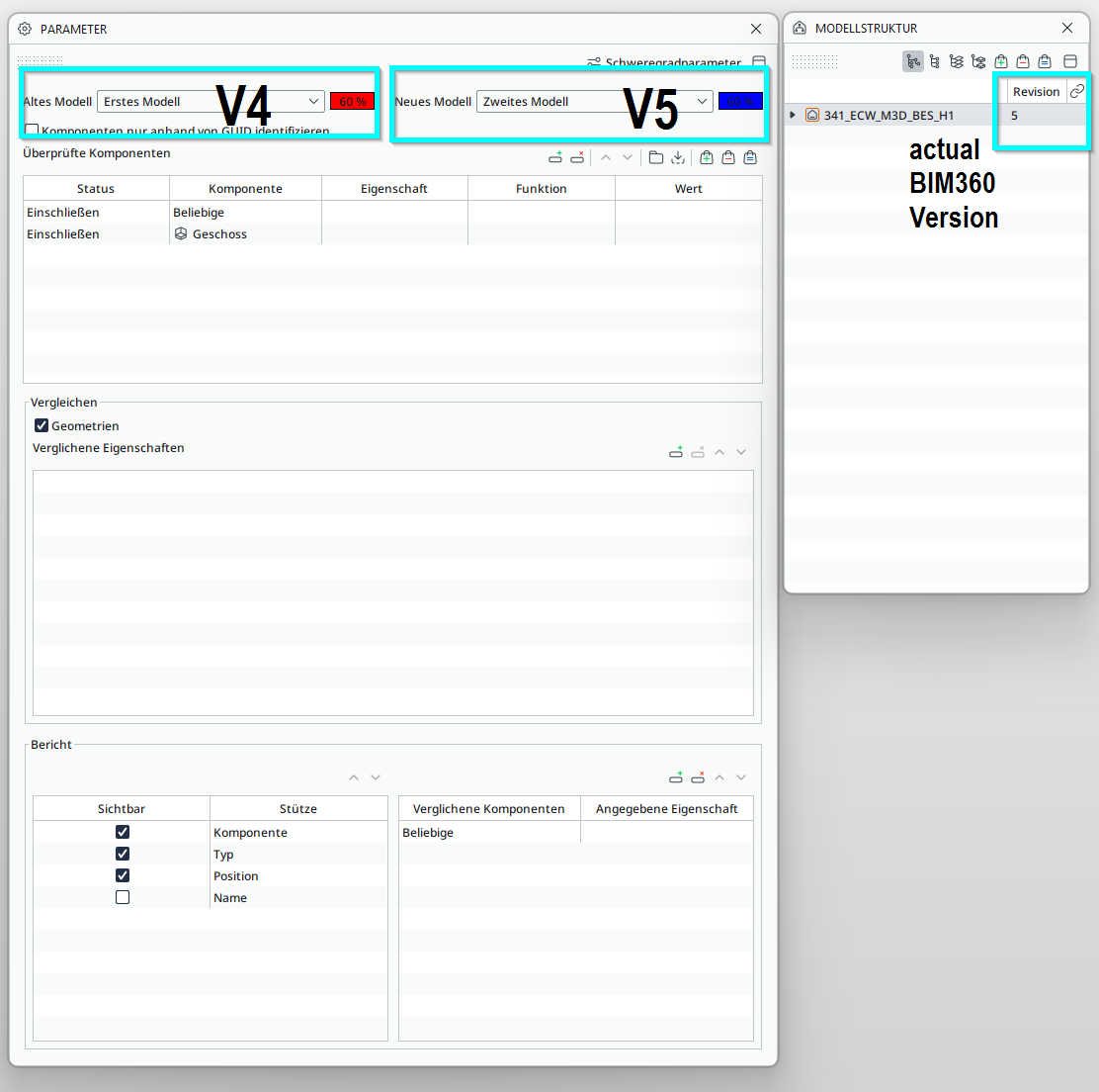

    We often face challenges when receiving updated models from external planners, as we need to consistently compare the new IFC version with its previous one. With the integration of BIM360 in Solibri allowing the actual version to be updated directly, is there a way for Solibri to recognize the version history in BIM360 and automatically compare models between versions?
    Thank you.
      wrote on last edited by Matti
      We don’t support opening the older versions currently from remote integrations. Very nice improvement idea.
      Now you need to download the files manually from the website for the comparison rule 206.
