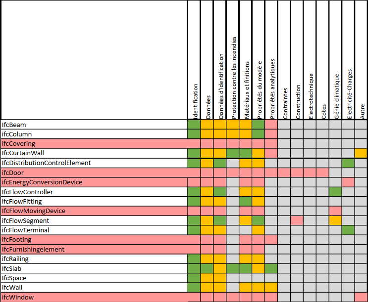

    i just want to know if i can do an ITO for Pset and IfcEntity without cheking all the proprietes of my Pset because solibri wants me to check a property everytime , i want to get by the end an excel file where i can do like this

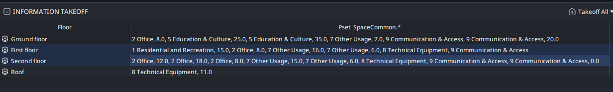

      I didn’t fully understand, but in ITO you can use wildcards * ? in property set or porperty names.
      E.g:

        thank you matti for the reply, the wildcards i guess that they are done in excel or something after the ito , what i really want is extracting only the pset and and the ifc entity , like shown in the image but solibri everytime i select a pset like données or identifiaction , i must select a proprety , he doesnt extract all the propreties at once
