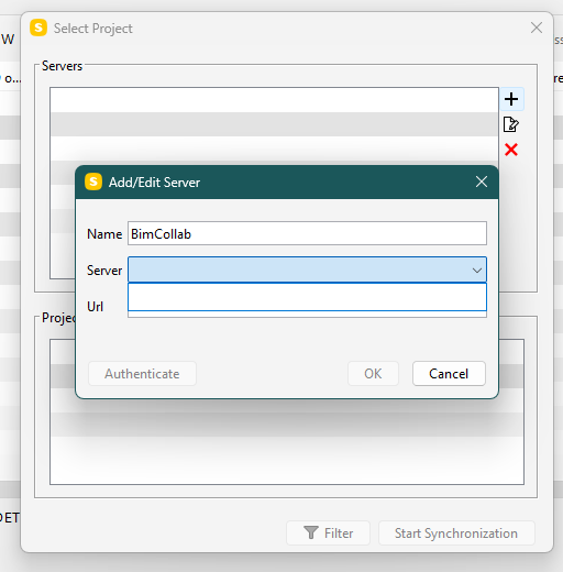

    I’m trying to add a BIMCollab project to Solibri, but when trying to select a server the list seems to be empty.
    I’ve searched the webs, but everywhere i look this seems like everyone just already has a full list to choose from.
    Please help, as i have no idea where to start looking for the solution!
    Also see the picture attached.

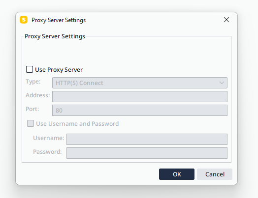

      From experience, this is generally the case if the Poxy settings is enabled (but not used): https://helpcenter.bimcollab.com/portal/en/kb/articles/solibri-bcf-live-connector-tips-and-troubleshooting#No_projects_available_for_BIMcollab

        I’ve checked, but according to the Proxy Server Settings it is not enabled…
        So that shouldn’t be the problem
          Please contact Solibri support, you could include the log file in the email: “C:\Program Files\Solibri\SOLIBRI\log\runtime.log”
          I also expect this is a proxy related problem.

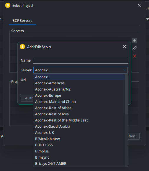

            After restarting and logging back in I tried it again, and when i clicked the ‘+’ to add a server now immidiately a pop-up window appeared saying “collecting server data” (or something similar). After like 10-15 sec all server are now loaded and available as options.
