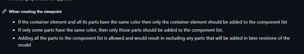

    in the bcf documentation you can find the following instructions:
    For me the first bullet point suggests, that if I find a GUID in the componentslist that corresponds to something like an IfcElementAssembly for example, I have to apply that components visibility or color or selection to all the components in that assembly.
    Now I have stumbled upon this visibilty node created in the BCF-Live-Connector.
    The selected Component is an IfcAssembly. All the other components are components contained inside that assembly, which means that the first and the second bullet point applies. Is there a reason why the IfcElementAssembly is added to that list?
    Solibri displays the Viewpoint correctly according to the snapshot, I’m just wondering why that IfcElementAssembly is added to that list?
