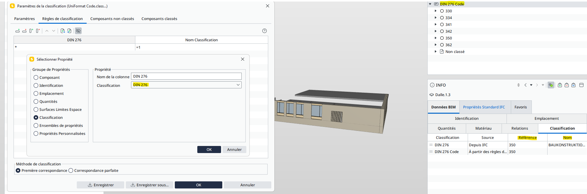

    Hello Solibrians,
    I would like to create a classification to check if elements have a DIN 276 code and description. The problem is that when selecting the classification property from IFC, I can’t select the reference and the name separately. When selecting the classification, only the reference is taken into consideration.

        @Hamzalaalaoui
        The Discription is a automatic created from the IFC. This is not a value you can use in Solibri.
        If you want to do this you can ask the moduler to ad a property-set with this in it. Than you can use de discription
