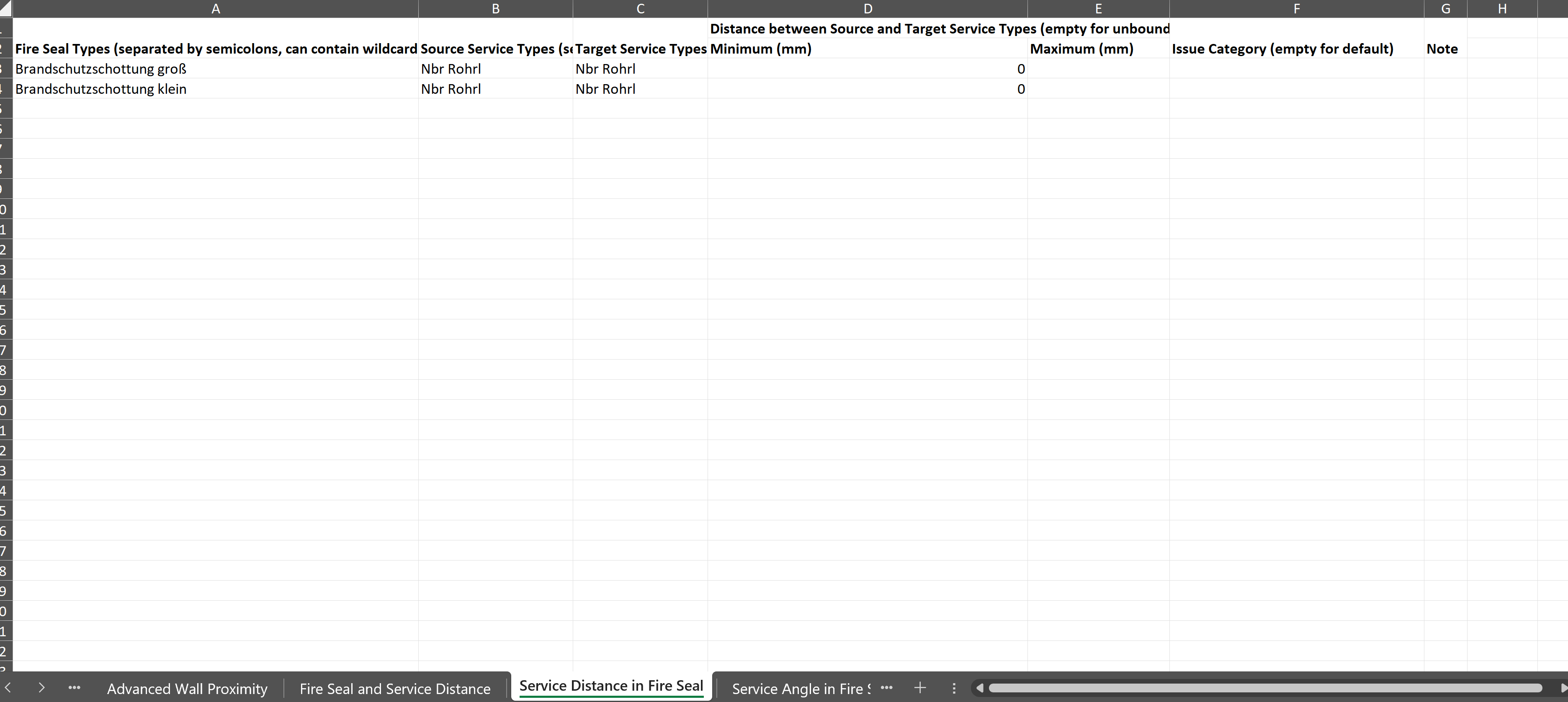

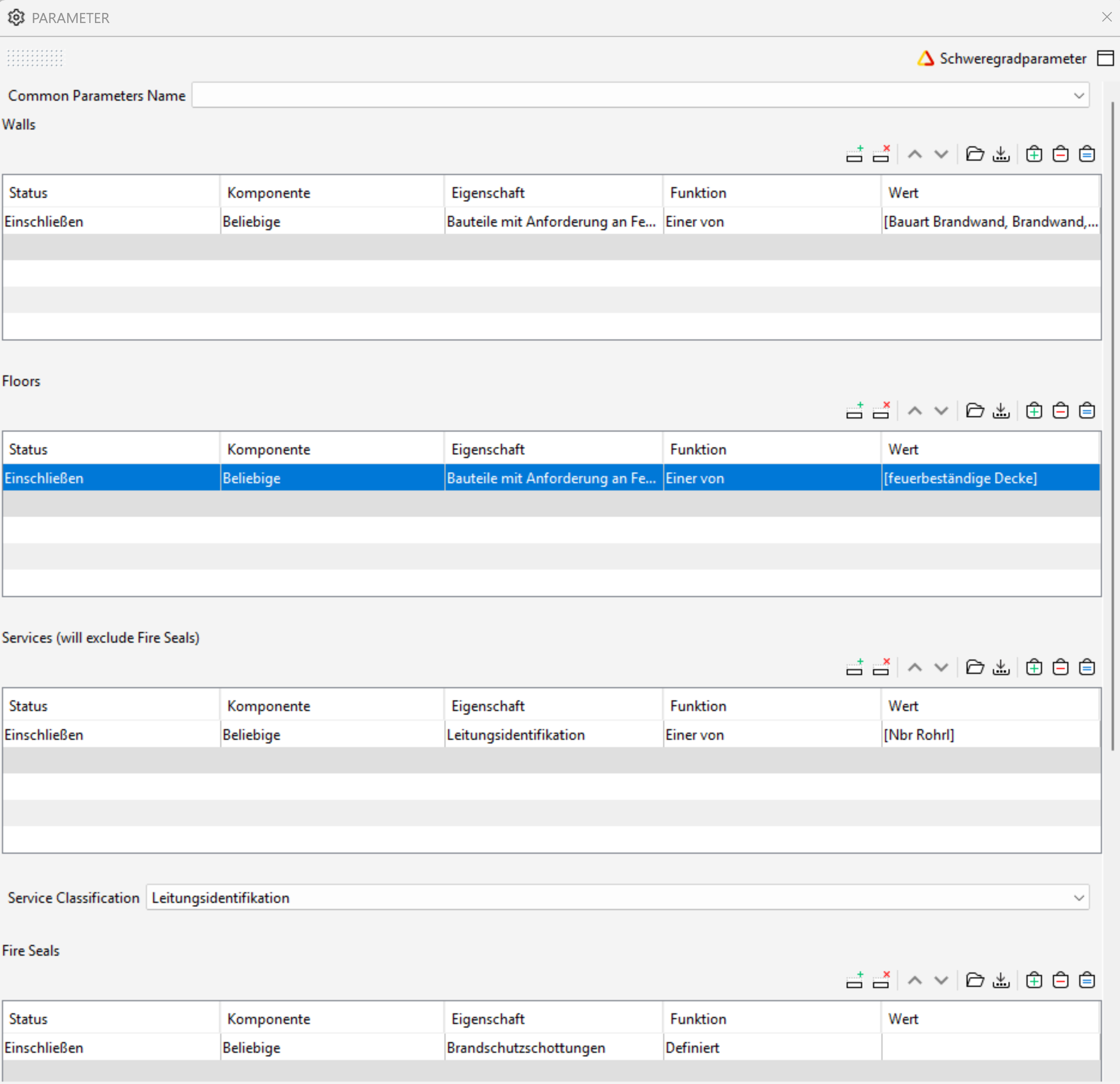

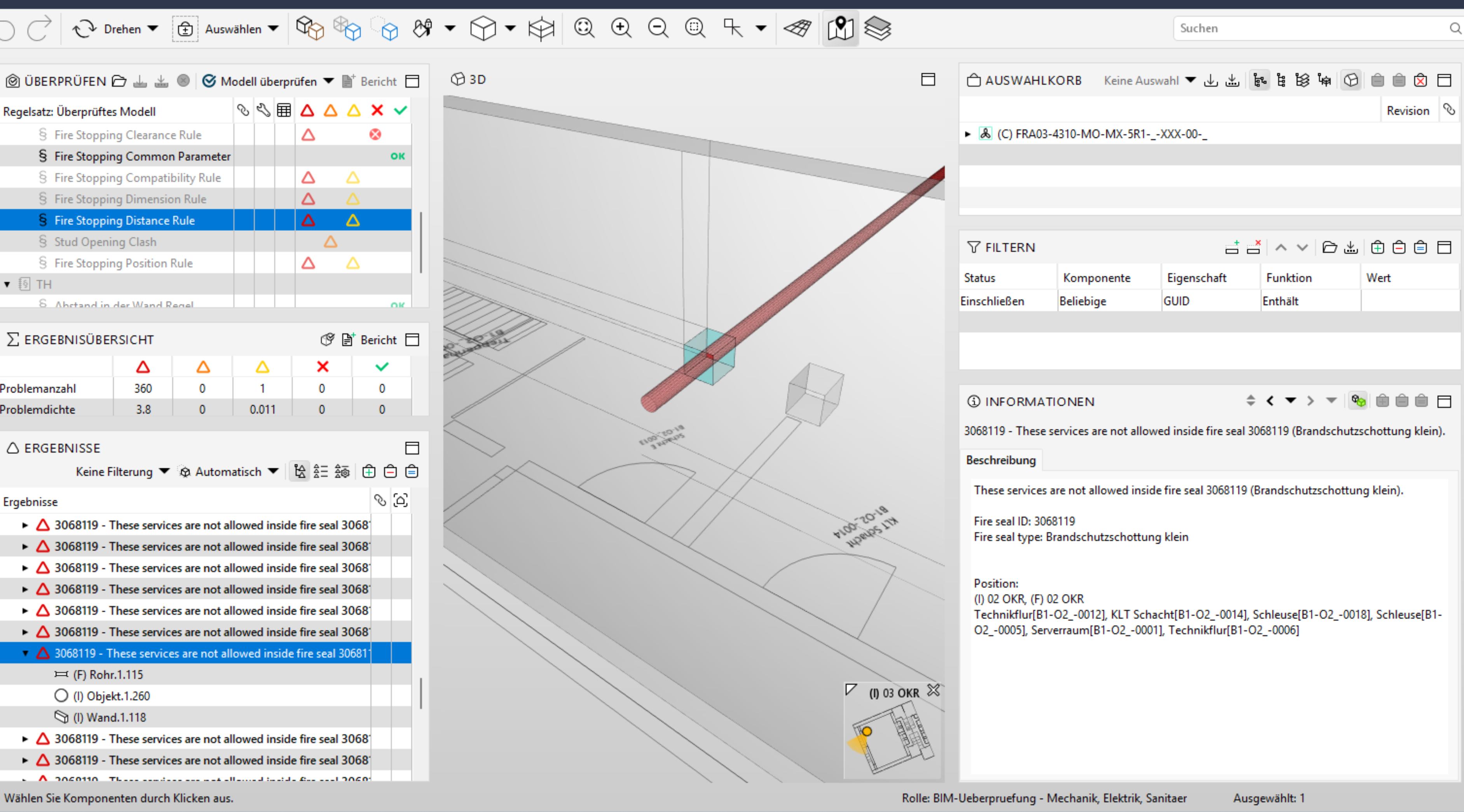

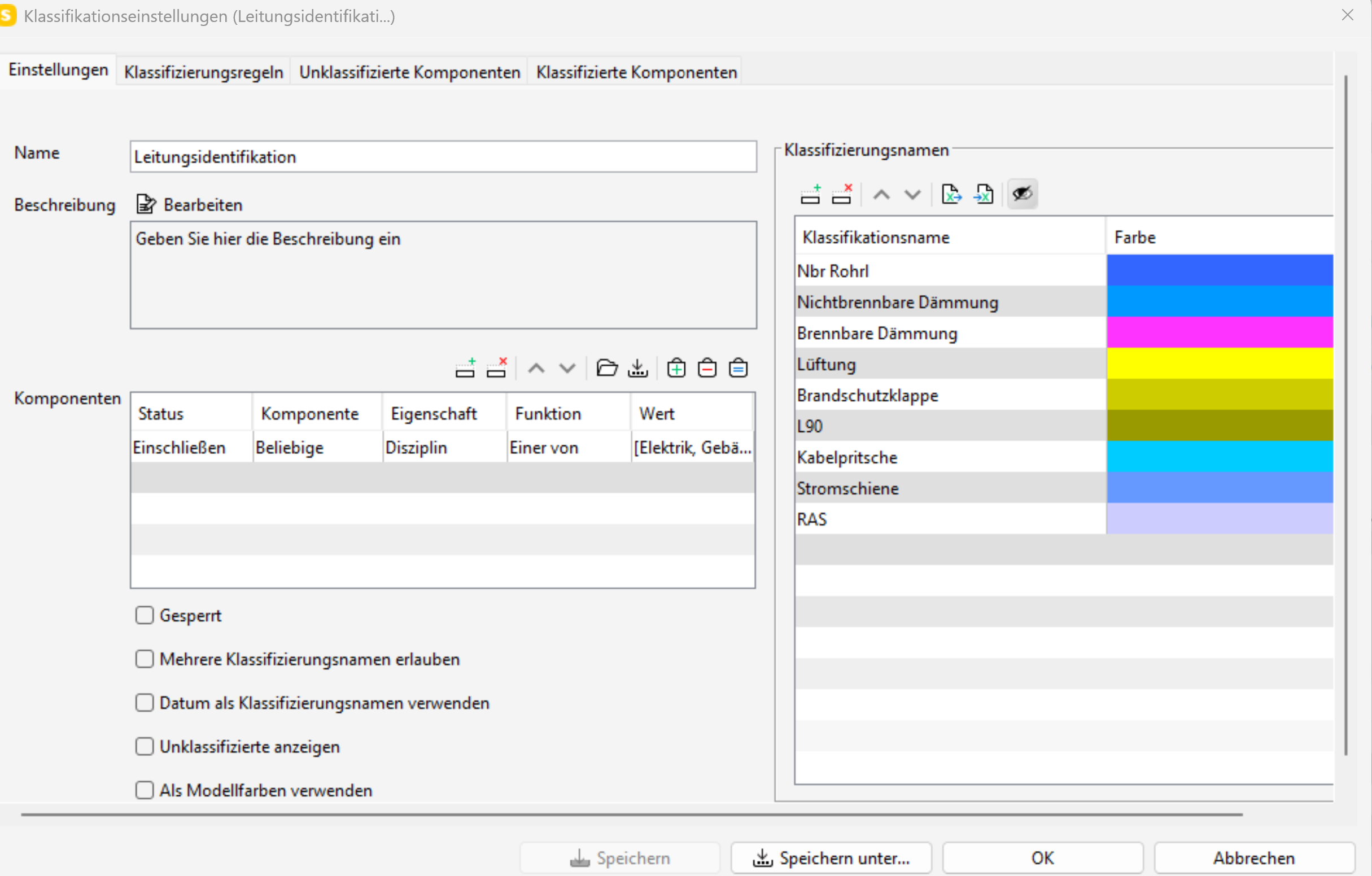

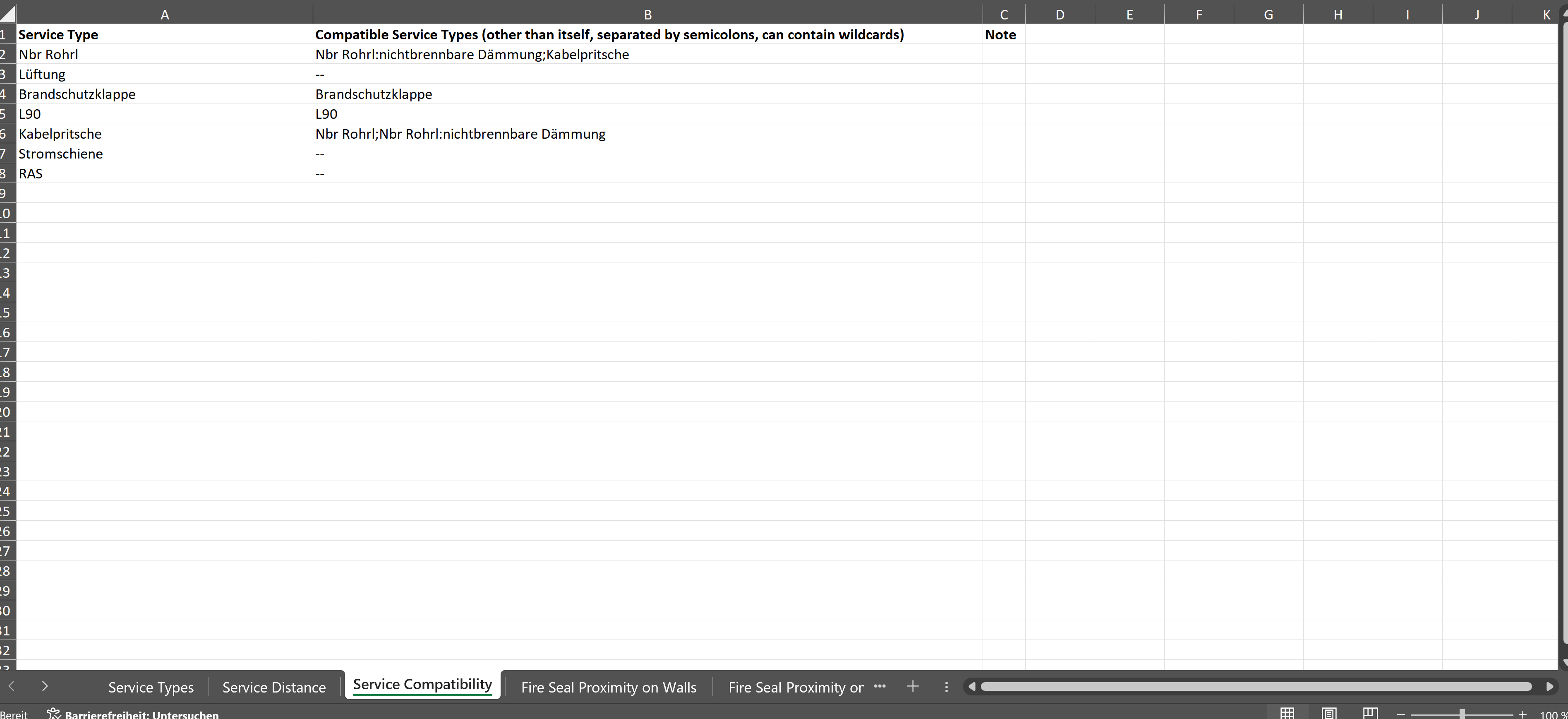

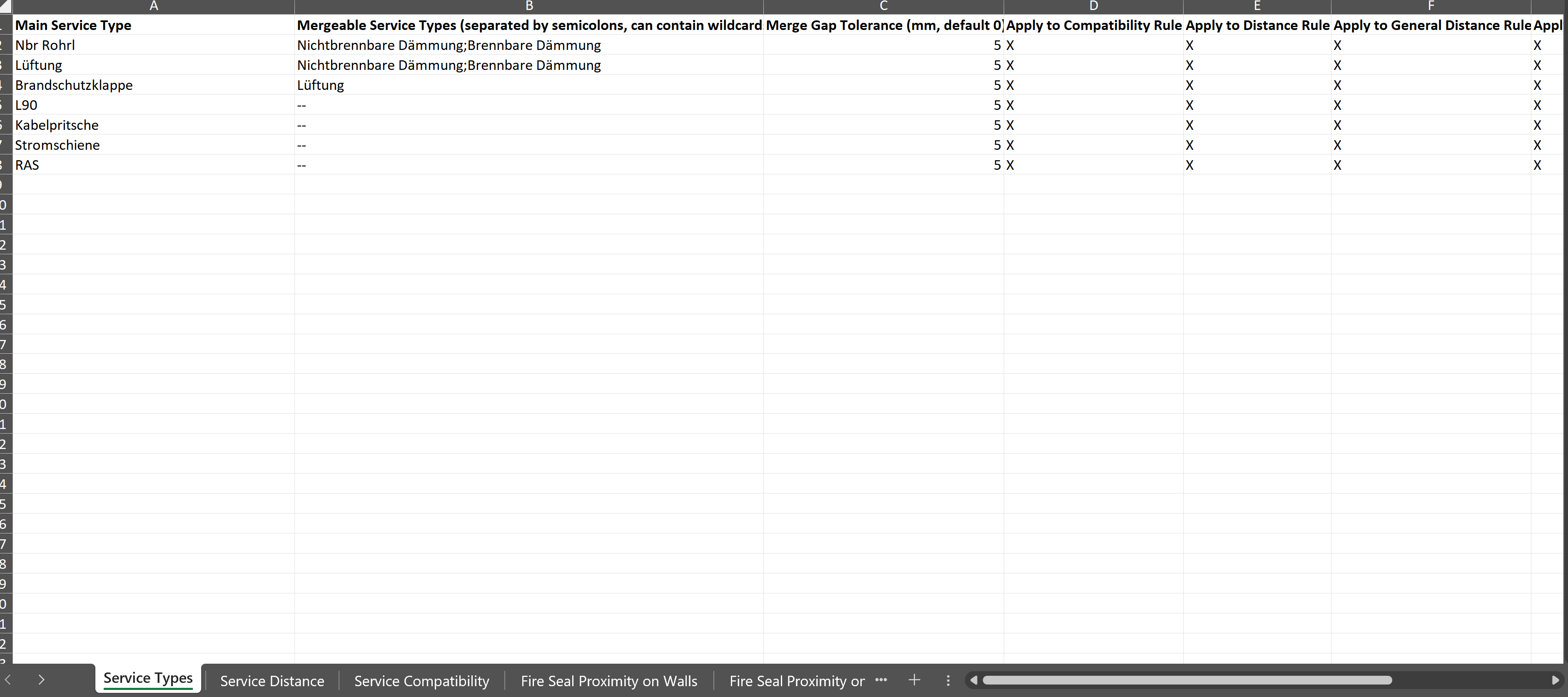

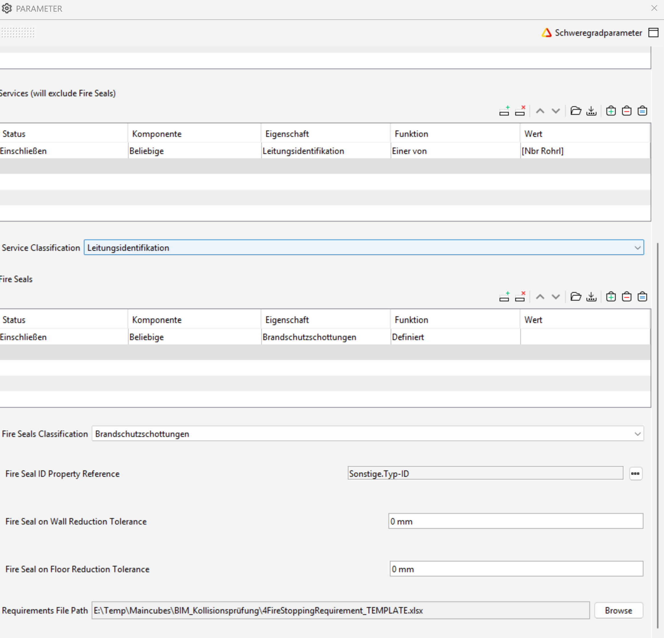

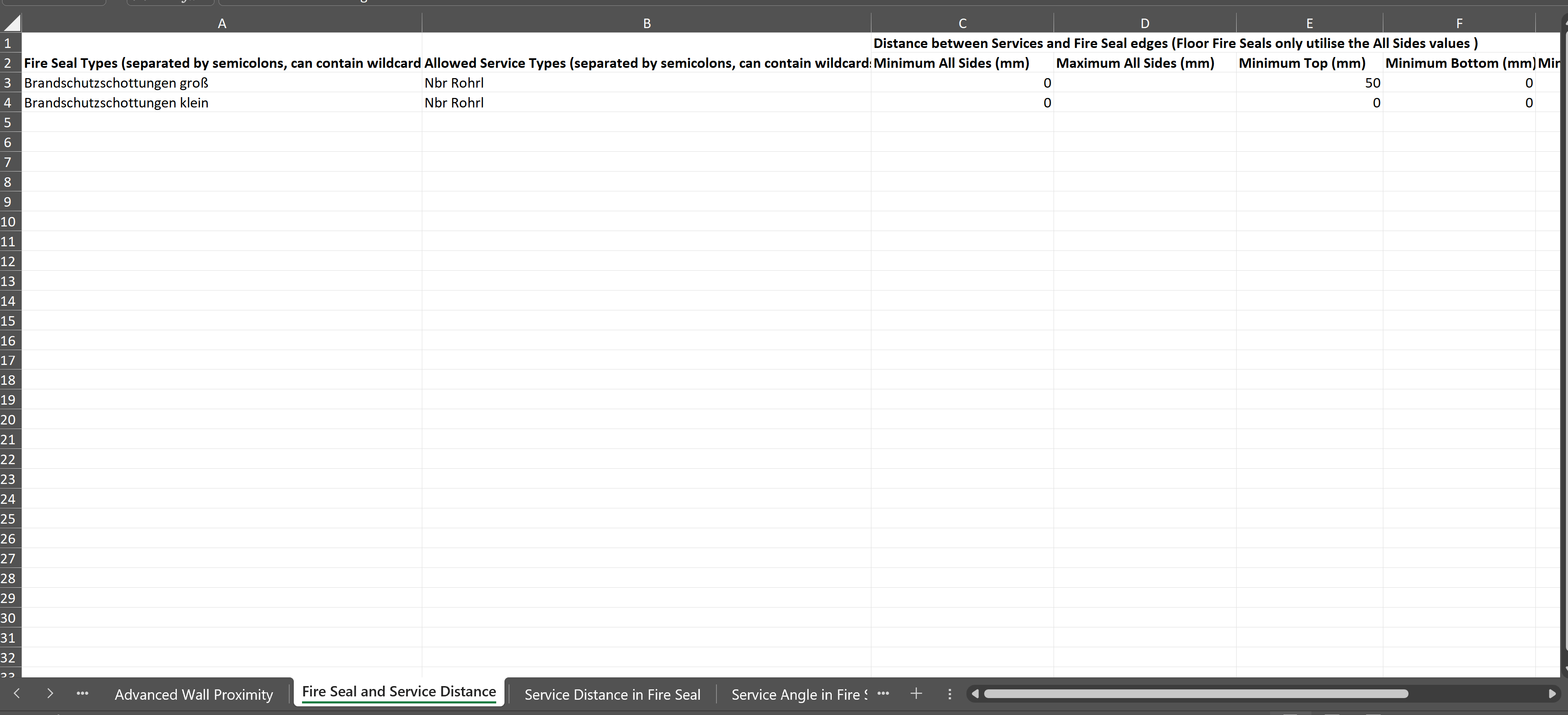

    When applying the rule, services entered in Excel as compatible are reported as incompatible line penetrations.
    I’ve tried every conceivable combination and adjustment in the classifications, excel-tempate and rule parameters, so far without success. Has anyone had the same problems? I appreciate any help.
