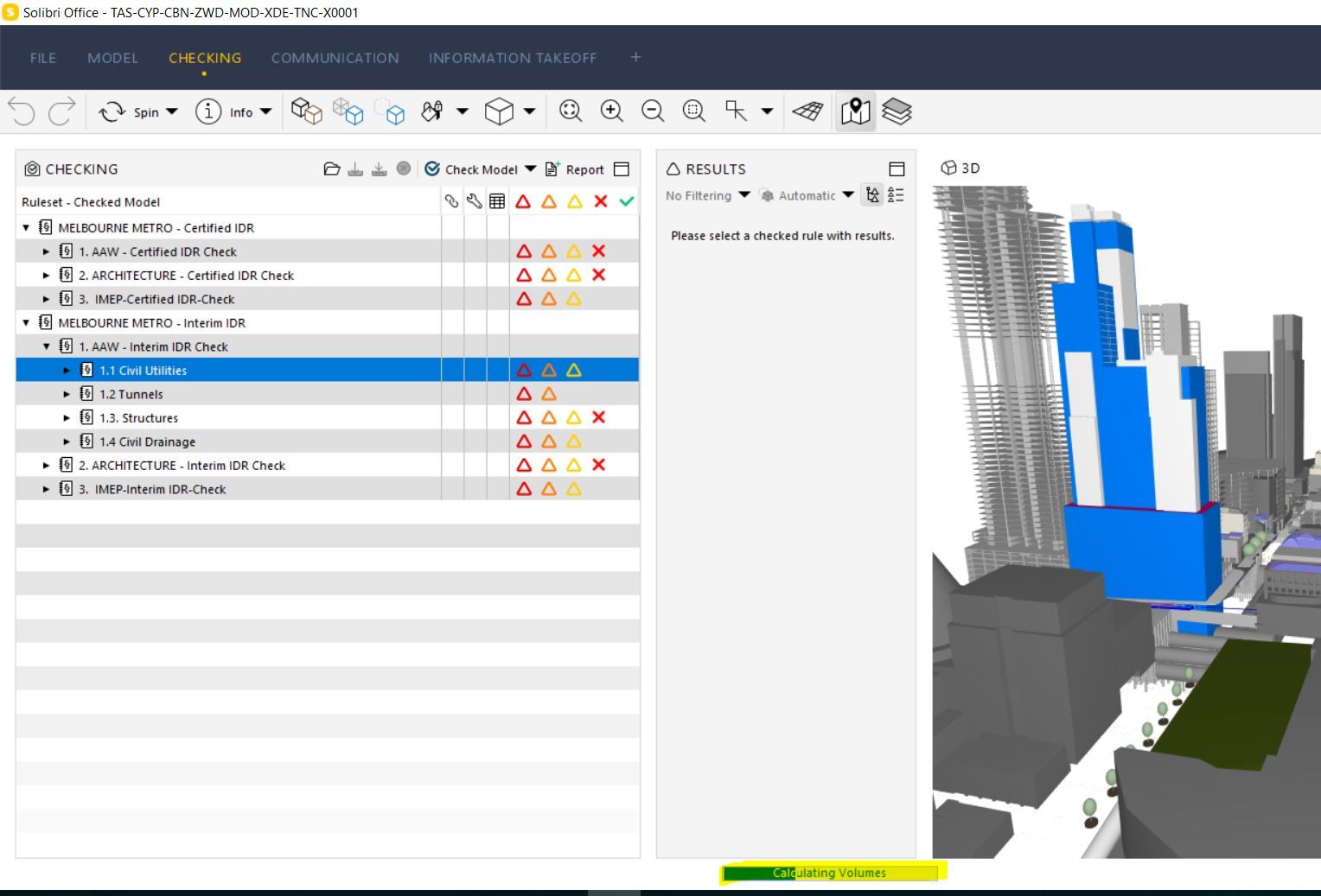

    Hi, Is there anyway to reduce the “calculating of volumes” when opening a model or when processing the rulesets? See attached sceen shot. thanks,Capture.JPG

      You can try to add this line to Solibri options file:
      C:\Program Files\Solibri\SOLIBRI\Solibri.vmoptions
      -Dmodel-volume-max-layers=5
      This limits the buildings total volume calculation to 5 horizontal layers.
      Note: This lowers the accuracy.
