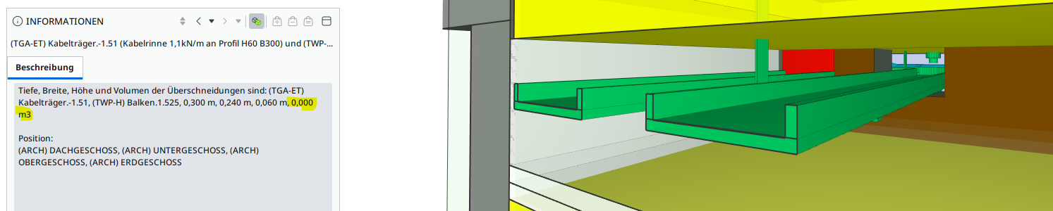

    Unit settings are not defined within the file but in the software settings. Therefore this has it’s flaws if one of my colleagues does not have harmonized settings.
    At some point I realized that setting a 0 as volume tolerance is helpful to filter out those false flag intersections which are below the set decimal threshold.
    However I am always afraid that if somebody else is using this file and ruleset with different unit settings (like the default settings) that checking results might not show all issues anymore as the rule now checks something completely different.
    Is this fear is unfounded as the values are still stored but not displayed or is this a potential trap?
