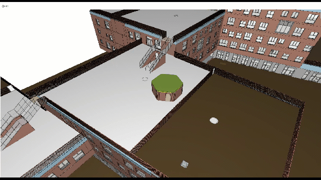

    I guess that the orientation of sections is defined by the orientation of face normals but I have no idea why some elements seem to be flipped and therefore the planes are not like I want them to be. Any ideas why this is happening and how ot prevent it?
    Example: When I click on the white roof covering the plane is upside down.
