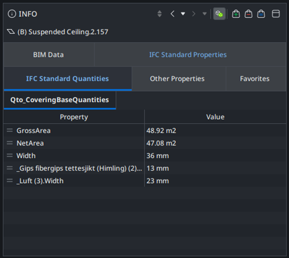

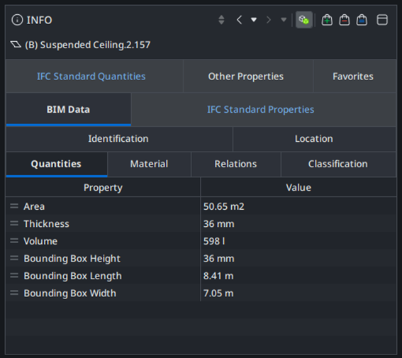

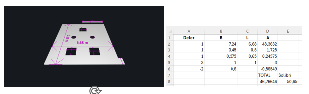

    I have a ceiling with some opening that was created in Revit.
    It looks like Solibri calculates the area without finding the openings:
    While from Revit one can get the right net area.
    e58d9b27-02d2-4a59-a867-8aeb45b26904-Ceiling.ifc
    Does anyone knows why and how to fix this? Even how to model the openings in Revit to avoid this issue?
