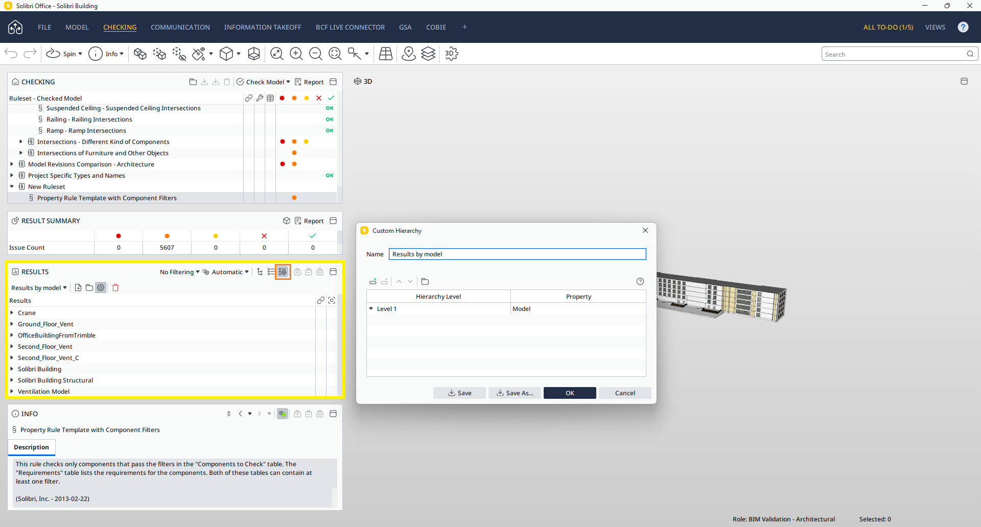

          Not sure if it is of any help here but you can create custom hierarchy in the Results View and categorize it by a model:

            We have experimented with that. However, we couldn’t easily submit issues to our BCF server from those groups. We want to set these configurations as default for all our users. Currently, we can only set up standard roles that each user has to load themselves. Should we check if we can include this setting?
              There is also possibility have gatekeeper rule for each model
              • Model A Gatekeeper
                • Rules
              • Model B Gatekeeper
                • Rules
              This way the results are grouped by the model in the results and in the result summary report.
