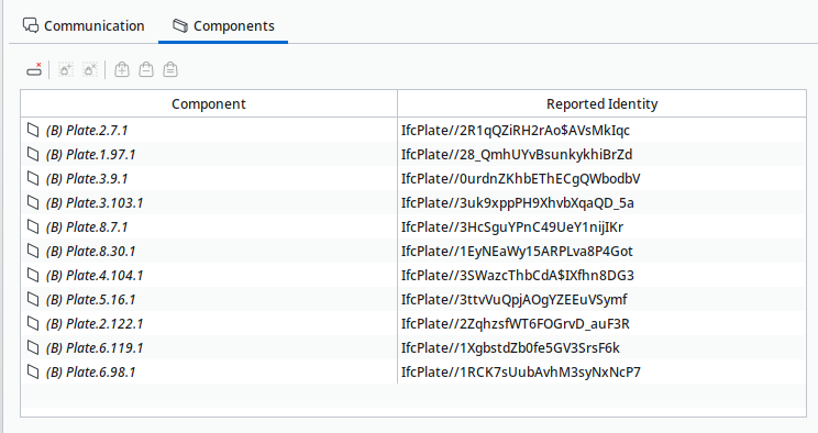

I have also noticed another behaviour: in Solibri, before saving the issue, the Issue Details window correctly shows the related components in the component table. However, after the issue is uploaded to Forma, the linked components section is mostly empty.

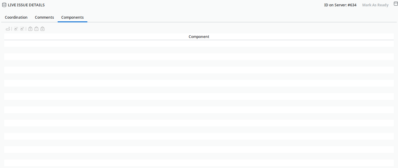

The original Solibri snapshot is still available, but it is no longer the main thumbnail. In addition, after synchronization, the components table appears to be empty.

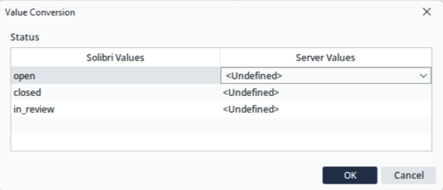

Besides this, I am still experiencing the Value Conversions window issue after some hours of connection, where the only selectable value shown is “Undefined”.

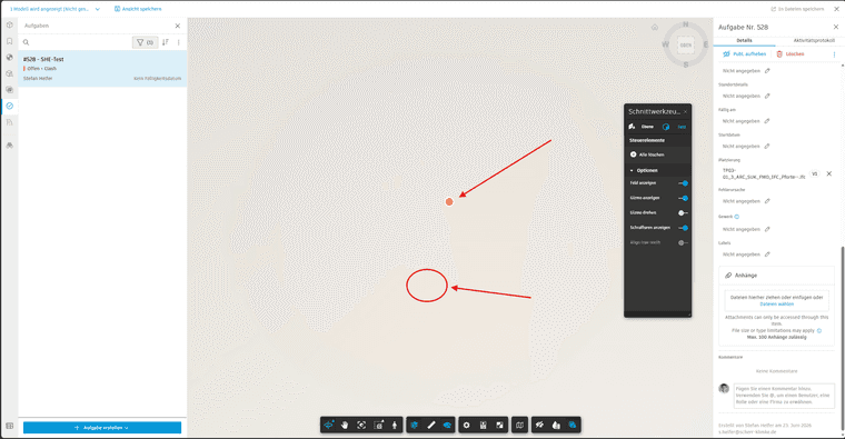

I am also trying to make BCF sync to Forma work, but with very little success. The issues do not have any placement in Forma. I manually “placed” one issue to corresponding NWD-file and pinpointed the location to correct location in that model. Strange enough, the pinpoint symbol (the red cross) appeared in Solibri quite close to the origin. Seems to be actually the same distance from origin in millimeters than the correct location is in meters.

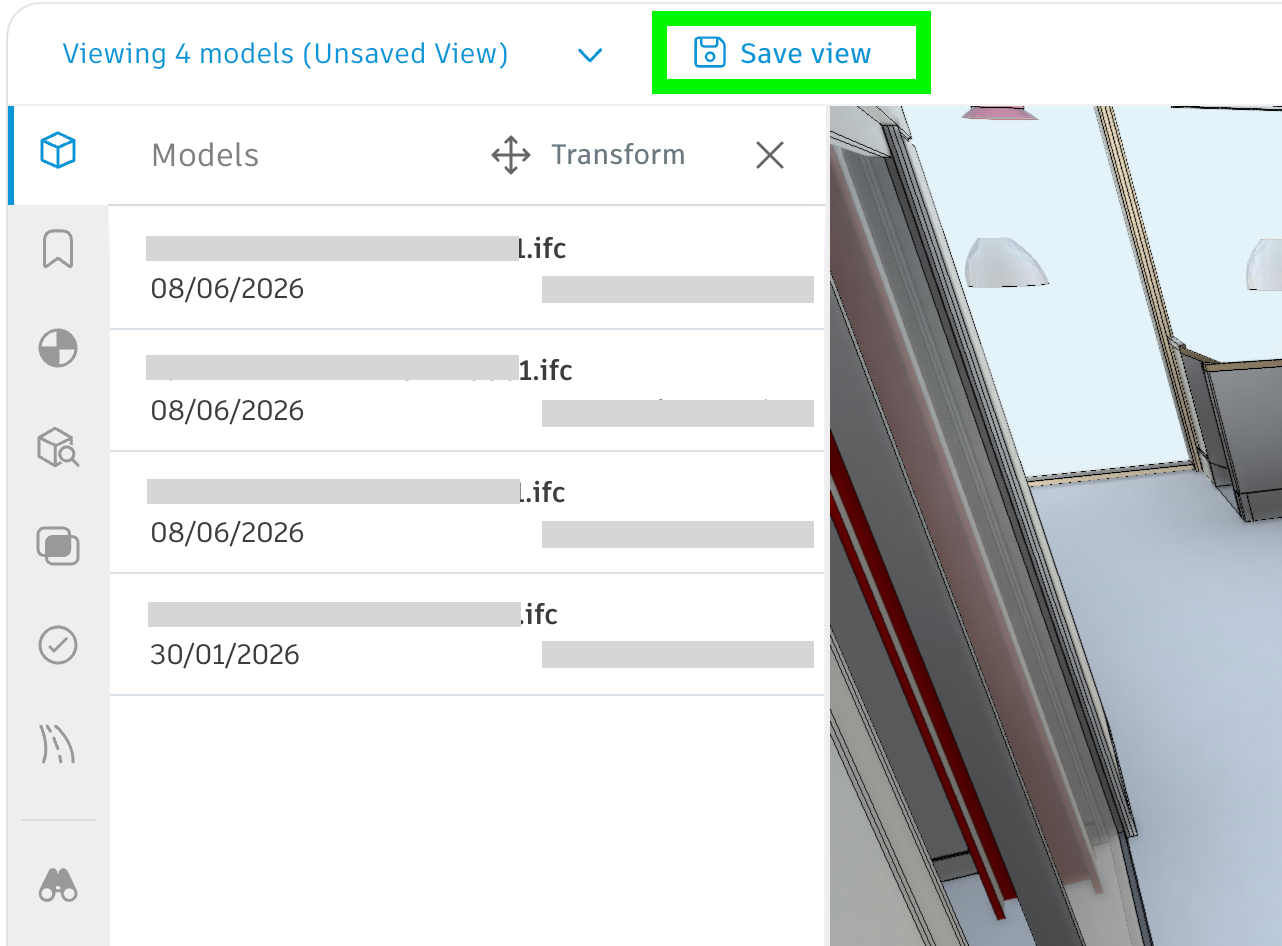

2. Viewing federated models in Forma: Opening up the model from the Placement field will indeed open only one file (the one file where the pushpin is located). In order to view in the federated model, it is good to create seperate views with the models impacted within Model Coordination. This will ensure that when working with e.g. 5 models, the federated view will include those 5, and all of the issues synced to that Model Coordination view will be available there, directly in that specific view, under the Issues section on the left hand toolbar.
